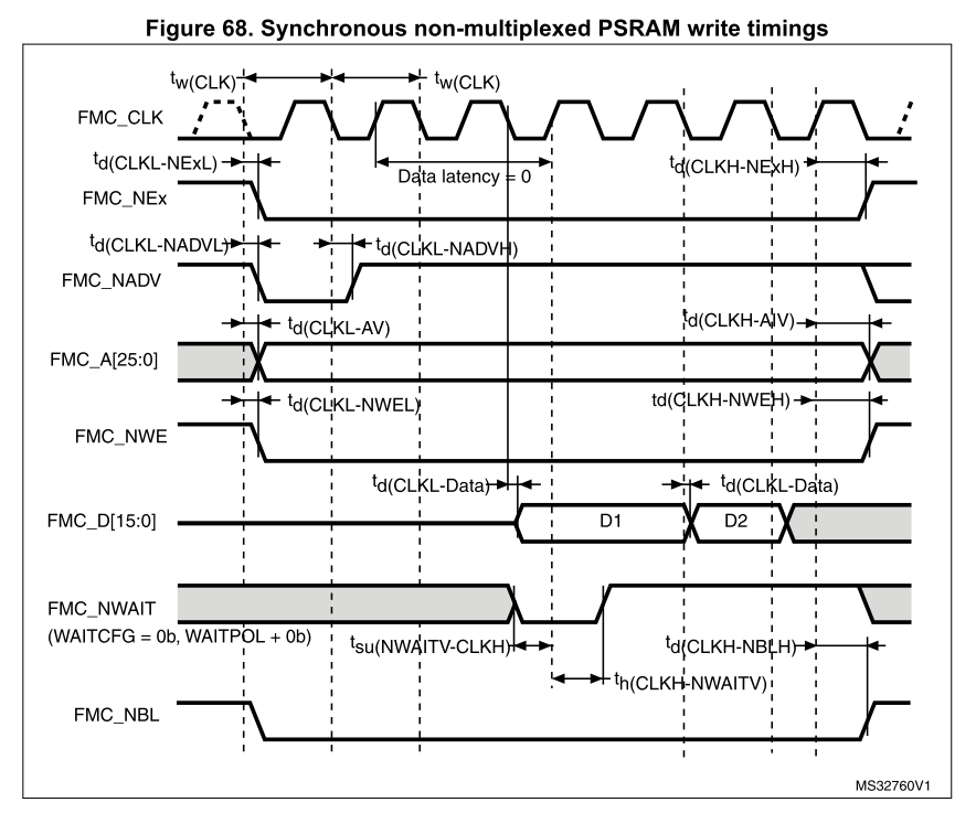

I have FPGA with memory mapped peripheral what I would like to control from external STM32 MCU (STM32F767 ). I chose FMC peripheral in synchronous PSRAM mode because communication can be easily implemented in HDL wrapper. I was inexperienced in this stuff so firstly I just connected logic analyzers to FMC bus, made some configuration and did some write accesses 'into air'.
Unfortunately I have faced some problems what I don't understand.
My configuration for all PSRAM banks:
DataAddressMultiplex = off;
MemoryType = PSRAM; MemoryDataWidth = 16b; BurstAccessMode = on
WriteBurst = on;
Wait signal manage = off WriteOperation = on; ExtendedMode = None ContinuousClock = on WriteFifo = on; PageSize = none;
Timing:
AddressSetupTime = 15; AddressHoldTime = 15; DataSetupTime = 255; BusTurnAroundDuration = 15; CLKDivision = 2; DataLatency = 2; AccessMode = MODE_A;

' in FMC transaction from following AHB data 'stream'. Please see attached pictures (1.png - 6.png). Pictures are screenshots of FMC entries from logic analyzer (see code above).
You can see values of D0-D7, A0-A4, NE1, NADV a CLK signals in FMC transactions. NE1 is basically same as NWE signal. Cursor 'C1.2' points at rising edge of clock where low 16b data from 32b value is written. Following rising edge should be remaining high 16b part.
After that NWE/NEx signal should be deasserted acording to reference datasheet but not in my case. You can see in first two pictures (1.png, 2.png) that two 32b AHB transactions were done in one FMC write. Sometimes I observed 3x32b in one FMC operation. Remaining FMC entries are ok from my point of view - values from 0x00090008 to 0x000F000E are written correctly.
This problem doesn't happen when write FIFO is disabled, but I don't know why...I have found nothing about it in reference manual.

Posted on October 30, 2017 at 14:54
It has the same waveform as NE (enable chip).
NWE is asserted when write operation is done.
Just see Figure 68. Synchronous non-multiplexed PSRAM write timings
In my opinion there is error in Data latency value - it should be 2

Posted on October 30, 2017 at 15:18
I've seen the waveforms in RM/DS, but the FMC is quirky and badly documented in details, so it's not out of interest to see the actual behaviour. Did you try exactly those settings from the table in RM?
You may perhaps want to start from the asynchronous case. I'd also recommend to avoid intermediate 'layers' and work directly with the registers - there are only 2 (3) of them.

Posted on October 31, 2017 at 14:27
My colleague successfully use PSRAM mode on STM32F407.
There is not so much difference between FSMC (F4) and FMC (F7). I only use continuous clock feature.
The point is that FMC SHOULD be blocking for write/read accesses but obviously it is not my case. I can only block CPU when NWAIT is enabled and in active state. It has to be problem somewhere else (cache, AHB...)
