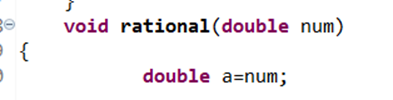

float argument inside function stopping the infinite loop. screen sorts and file are given below. Edit: mcu I'm using is stm32f411re .
GMond.1
0693W00000JMx5tQAD.pngif I give argument like above picture infinity loop stops working
0693W00000JMx6wQAD.pngbut if I give the number num inside function the instead of giving argument then its working fine.
If I give int instead of double as the datatype of argument then also it's working.
Please help

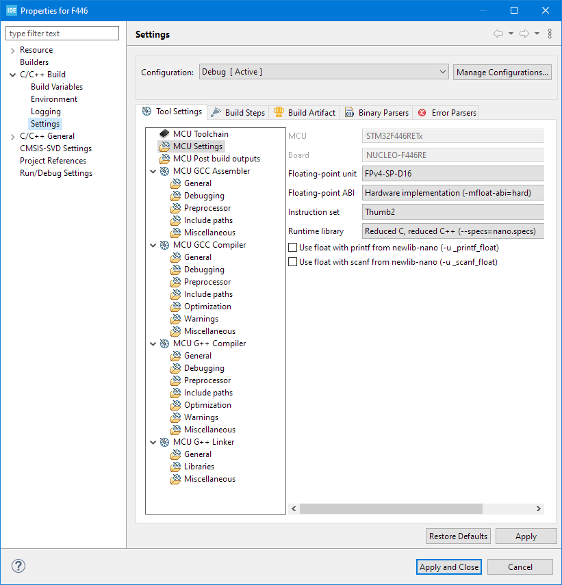

S.Ma
Principal
Try to increase the stack size
Right click on the project name / Properties / C/C++ Build / Settings
