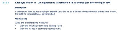

I am using the STM32F030 for a sensor with a RS485 interface.
In my tests, I am sending a 8-bits message (constant value) to the STM32 in a loop. When I look at the data received, the last byte is at the first place, always. There is never any other or additional shift.
I can understand it is byte remaining from the previous comm and missed out from the previous reading but why is it so stable (always one byte and always the correct one).
Any idea about the reason of this ? And more usefull, do you have any method to clear the DMA buffer before starting reading ? Would you recommand the use of a circular buffer for the DMA ?
On one side (transmitter)
message_TX[0] = 0x02; ...; message_TX[6]= 0xDE ; message_TX[7] = 0xAC;
HAL_UART_Transmit_DMA(&huart1, (uint8_t*)message_TX, 8);
On the other side (receiver)
HAL_UART_Receive_DMA(&huart1, (uint8_t *)message_RX , 8);
And I get the following data in message_RX[0] = 0xAC (always) and message_RX[7] =0xDE (always)
Any suggestion for me ?

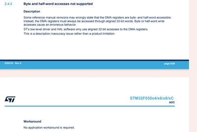

Maybe one of those 3 errata is the source of your problem.
 if not, i Suggest you to do the send all the 8 bytes byte by byte using a for loop that send the byte 1 juste after receiving an acknowledge that the byte 0 was well received...
Best regards.

Maybe  the third one but as far as I read, it seems the HAL_UART_TRANSMIT_DMA and HAL_UART_RECEIVE_DMA deals with uint8 and uint16. But what to set up in the CubeMX config panel.
You have to do exactly as sayed in the errata.
Best regards.
II
In the HAL file, there is
AL_StatusTypeDef HAL_UART_Transmit_DMA(UART_HandleTypeDef *huart, const uint8_t *pData, uint16_t Size)
This is 8-bits data...  and there is no other suggestion than using 32-bit... but does it mean that the HAL files are wrongly written ? Because, it is written in "write access" so only when I send (TX) bytes... not at the reception (RX) as there, I do not write in the DMA registers....
Do you have example linked to this errata ?
