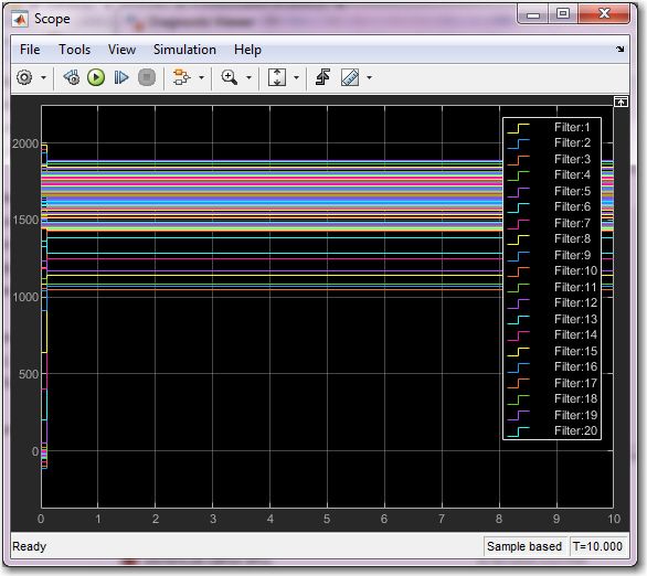

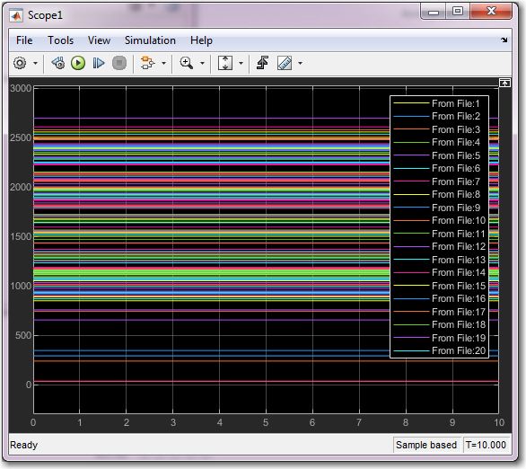

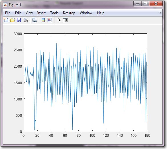

Here's the output from simulink, I haven't put on the chip yet,
I'm not sure yet.....
Output from ADC 180s, 3000mV max
Output from Simulink before filter
output after filter :

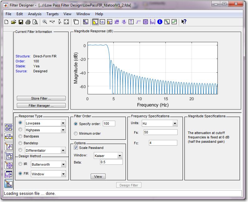

I want to filter a signal more than 4Hz, but pass 0- max 4Hz
Filter design :
How to get the C code for it ?
