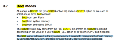

According to the AN2606 and DS12288, the boot loader is located in the system memory. It is used to reprogram the Flash memory by using USART, I2C, SPI, and USB through the DFU (device firmware upgrade):
So, the FDCAN is not an option.

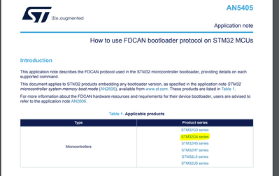

but According to AN5405 , STM32G4 series is supported for FDCAN bootloader.

The AN5405 is for both Bootloader and open bootloader which is supported by the STM32G4 series. But the Bootloader is not available on STM32G4 series devices.
Best Regards.
STTwo-32
You'll have to code something that suits your needs, or pick a different device
