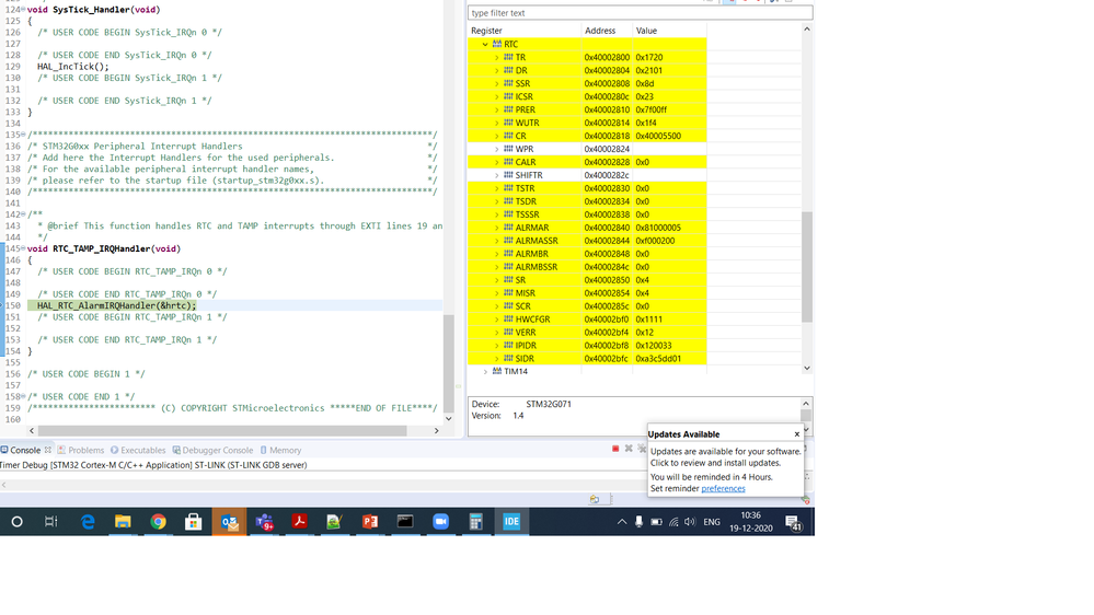

0693W000006GMrNQAW.pngHello,
I am facing a strange issue with STM32G0 RTC. As soon as I initialize RTC, it generates an interrupt and it never comes out of the interrupt. Same program was working previously and suddenly it started throwing this kind of issue. I am wondering what really went wrong

  if (HAL_RTCEx_SetWakeUpTimer_IT(&hrtc, 500, RTC_WAKEUPCLOCK_RTCCLK_DIV16) != HAL_OK)
    Error_Handler();

HBavi.1
Hmmmm.. It was my mistake.. Somehow handling of wakeup interrupt got removed from my code and I didn't notice it.
