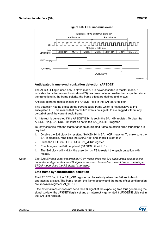

['F446 documentation] SAI - confusing note for AFSDET
waclawek.jan
Posted on January 16, 2018 at 12:59
In the context of previous sentence, this sounds like SAIXEN would have no meaning in SPDIF mode.
I'd reformulate the latter sentence as ''AFSDET has no meaning in SPDIF mode...''

Imen.D
Posted on April 06, 2018 at 17:06
Hello
Waclawek.Jan
You are right. It is a mistake, SAIEN must be replaced by AFSDET.
This is raised internally and it will be corrected in coming release.
