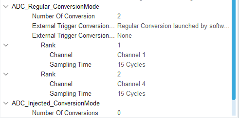

I tried to use ADC in F411 to read two ADC inputs.
My hardware is a F411-Nucleo board; my IDE is CubeIDE.
The followings are my ADC settings in IDE:

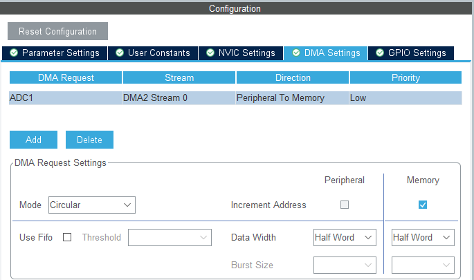

  • I use 2 channels in ADC1 (IN1, IN4)
  • I also use DMA to obtain ADC results.
I use
volatile uint16_t adc_reading[2]
to store the 2 readings.

I have two problems:
  1. Only adc_reading[0] has a valid reading; adc_reading[1] is always 0; even I define it as uint32_t variable and change data length as WORD. That valid reading corresponds to the voltage applied to IN4/PA4.
  2. The valid reading is only 8 bits long, instead of 12 bits; meaning value is 254~255  when I applied 3.3v to PA4 pin.

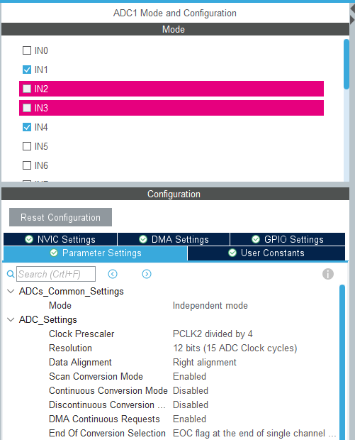

GwenoleB
Hello @HDaji.1,
Could you please try again by using EOC flag defined as 'EOC flag at the end of all conversion' instead of 'single channel conversion'?
Best Regards,
Gwénolé
Hi @GwenoleB
Still does not work.
However, I notice that there is something I did not do quite right.
I am testing on an F411RE-Nucleo board, while I select F411RETx in the board selection. Is it the cause?
I will retry from the board selection.
HDaji.1
Senior
I did again with Nucleo-F411RE in board selection step.
Now it's working.
However, the root cause is not clear to me.
