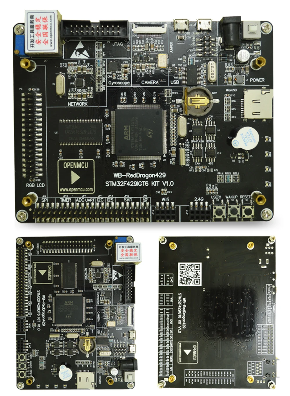

Nice board at affordable price!
Guess some one what a piece of ST's lunch
Does it actually need external RAM, internal's faster, what rate are you sampling, couldn't you just spill to the sd card using a 64KB DMA ping-pong arrangement?
TaoBao has had some cheap/compact boards that would work as streaming data recorders.
