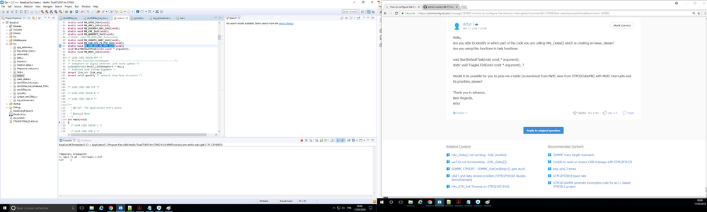

mY QUESTION IS
When I debug I put breakpoint on Hal_Delay . It blocks . when I put pause
to see where it is blocked
it is blocked in list.c file in for loop

What shall I correct when it comes to this function . What is the error
please .

when I leave it not changed it is blocked here
while((HAL_GetTick() - tickstart) < wait)
__weak void HAL_Delay(uint32_t Delay)
uint32_t tickstart = HAL_GetTick();
uint32_t wait = Delay;
// Add a freq to guarantee minimum wait
if (wait < HAL_MAX_DELAY)
wait += (uint32_t)(uwTickFreq);
Posted on May 16, 2018 at 12:48
I was referred to the project of F4 you told me.. but it is always the same
problem blocked in the list.c file in the for loop I sent you.
Can you help me to know what is missed or incorrect ????
Thank you

Posted on May 17, 2018 at 07:20
Are you able to identify in which part of the code you are calling HAL_Delay() which is creating an issue, please?
Are you using this functions in task functions:
void StartDefaultTask(void const * argument);
static void ToggleLED4(void const * argument); ?
Would it be possible for you to pass me a table (screenshoot from NVIC view from STM32CubeMX) with NVIC interrupts and its priorities, please?

Jessy J
Posted on May 17, 2018 at 09:58
I am using these functions as follow
/* init code for FATFS */
MX_FATFS_Init();
/* init code for LWIP */
MX_LWIP_Init();
/* USER CODE BEGIN 5 */
/* Initialize tcp echo server */
tcp_echoserver_init();
/* Notify user about the netwoek interface config */
User_notification(&gnetif);
/* Start toogleLed4 task : Toggle LED4 every 250ms */
osThreadDef(LED4, ToggleLed4, osPriorityLow, 0, configMINIMAL_STACK_SIZE);
osThreadCreate (osThread(LED4), NULL);
/* Infinite loop */
for(;;)
osDelay(1);
static void ToggleLed4(void const * argument)
/* toggle LED4 each 250ms */
HAL_GPIO_TogglePin(LED4_GPIO_Port, LED4_Pin);
osDelay(250);
I have a question . about TIM6 I should re write the void HAL_TIM_PeriodElapsedCallback(TIM_HandleTypeDef *htim) . but I did not know how
Y ou will find attached the NVIC ocnfiguration from STM32cubMX
Thank you in advance0690X0000060KoYQAU.png0690X0000060Kp1QAE.png0690X0000060Kp6QAE.png

Jessy J
Posted on May 17, 2018 at 12:12
I did not understand what you are trying to say .. I am using osDelay as delay for threads but it blocks in HAL_delay function
in the while loop
/* Add a freq to guarantee minimum wait */
Jessy J
Posted on May 17, 2018 at 12:13
when I put break point in the  HAL_TIM_IRQHandler(&htim6);. It does not go to the timer handler.. I checked the NVIC while debug .. all regiters are set to 0x0 .. I think its problem that tim6 does not launch but i am not sure
what do you think please ?
