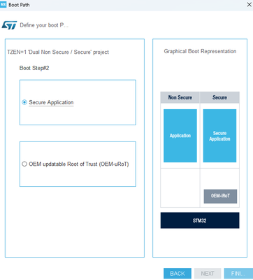

Boot path is configured as follows:

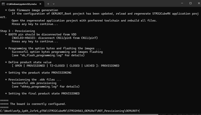

And I have run provisioning.bat, the product state was set to PROVISIONED:

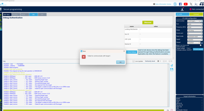

But after that, I could not do Debug Authentication to open debug for my EVB.

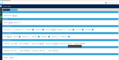

Below is the Option Bytes overview:
SECBOOTADD = 0x00000000, it should be 0xC000000 when TZEN = 1 and UBE = B4 (OEMiRoT), right? Could this be the reason that I can't do DA discover and perform DA correctly?
If so, how can I open debug to recover this EVB?
