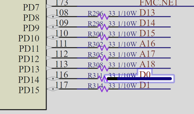

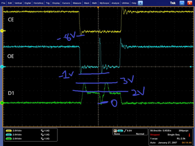

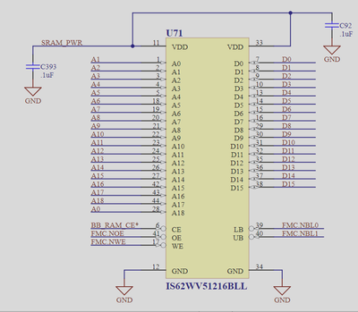

it passes the 16bit test but fails the 32 bit test
when i check a good board the D1 signal is high not fluctuating.
any advice?

Check the netlist for any conflicting connections.
Check the pin level configurations.
