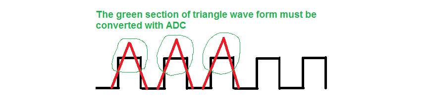

It works. When I connect the
EXTI_Line11
to the square wave the ADC convert the analog input and put them into the ADC3ConvertedValue. I adjust EXTI for rising and falling edge. I want to calculate data between two rising and falling edge of the external interrupt . But I dont know which section of the ADC3ConvertedValue is linked to the time of converting between two rising and falling edge of external interrupt? 0690X00000605QDQAY.png Regards

What exactly do you want to measure? The maximum/peak of the triangular waveform? You might perhaps want to build an (analogue) peak detector (basically a diode and a capacitor) and measure the voltage on that, perhaps at the falling edge; you can also discharge the capacitor actively after the voltage is measured. To work out the details is upon you though.
