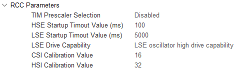

AScha.3
try: set in Cube -> LSE osz. : hi drive
low drive will not startup with some crystals.
(there is ANxxx about this problem, with list of tested crystals, running on low drive.)
