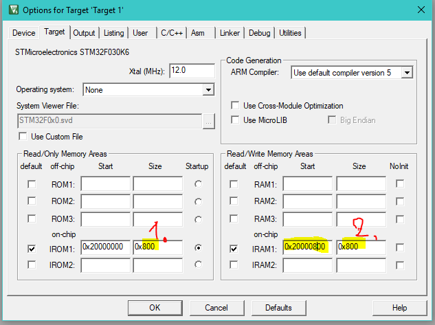

Posted on September 10, 2017 at 15:56
Hello!
This error means there is not enough space to put your image. (Flash or RAM)(look in scatter file)
If your program do not fit to flash (after size optimimization) , some other MCU with proper size will do the work.
In case you run your program from RAM, go to options tab
The total amount of your RAM is 0x1000 bytes (sum of 1  and 2)
Try to increase the size ofIROM1 (1)  and reduce the size of IRAM1 accordingly. (2)
The remaining IRAM1 must have finaly sufficient space for stack, heap, Glob. obj.
If finaly this ''adjustment'' fails,  you need another MCU with sufficient memory.
Rgrds
vf
Posted on September 10, 2017 at 18:21
'In case you run your program from RAM, go to options tab'
I don't get this.am I choosing where to run my program?
In that pic that u send is sum of 1 and 2 0x1000?
0x800 + 0x800 = ?
I'll check what u say.hope it work.thanks

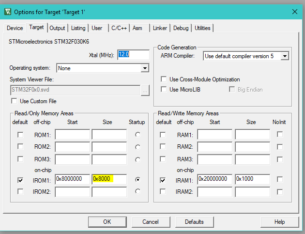

Posted on September 10, 2017 at 19:00
Hello again.
Yes you can load your program to RAM and run it from RAM. ( put vector table to RAM and program image to RAM)
>> 0x800 + 0x800 = ?
Yes the result  is 0x1000 , it is hexadecimal.
Finaly i understood that your program is run from FLASH.
So check also in this picture the highlighted amount of Flash memory for your device. Must be 0x8000  32Kbytes
If your program's  memory options are like this picture ... then  your options are to reduce your code size by 200 bytes , or to migrate to another MCU with sufficient memory.
Rgrds
vf

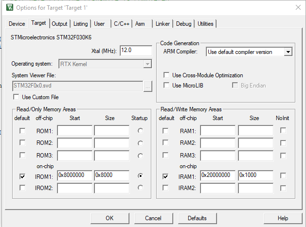

Posted on September 11, 2017 at 05:42
it is like this in default
what u suggest?
Posted on September 11, 2017 at 08:58
To reduce your code size by 200 bytes , or to migrate to another MCU with sufficient memory.
