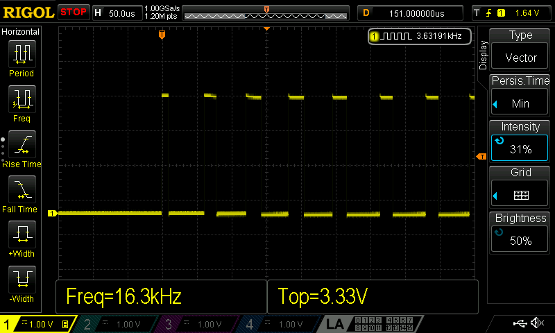

I am unable to communicate with the MCU via UART (115200 bit/s). It looks like the program inside MCU is not running. I think the problem can be probably in not running LSE 32.768kHz crystal oscillator.
Is it possible to enable LSE clock on PA8 if I have just the hex file to check it with oscilloscope? SWD via STLINK-V3MINI and STM32CubeProgrammer works great, I was able to upgrade the firmware with easy. I have S76G chip with STM32L07 inside.

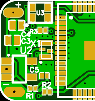

IMO the PCB design is OK, capacitors sound roughly OK too.
If this is a prototype, double/triple check if you don't have shorts between pins/tracks. Try a different crystal - what if it got damaged during soldering and/or tests?

When I changed the RCC_LSEDRIVE_LOW to HIGH it help to start the crystal by touching it by a finger, but the output frequency is 1/2 of 32.768KHz see picture:
I noticed that the crystal is soldered upside down i.e. Pin 1 input is going to OSC32_IN and Pin 2 output is going to OSC32_OUT. That may be the problem.
DRich.4
I have slightly modified the design for MEMS oscillator (SiT1533AI-H4-AA3-32.768E). Waiting for a new PCB to test it. Stay tuned ;-).
