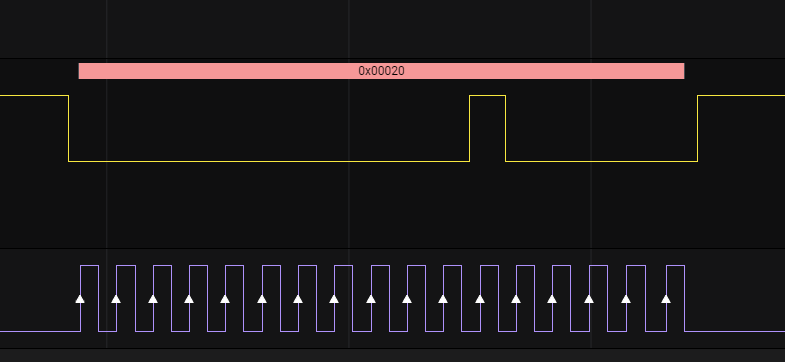

My objective is to read a stream of data intended for a shift register with 1.5us clock period.
There are 17 clock cycles and I want to sample the data at the transition (upper or lower).
Can this be achieved using SPI or should I just bit-bang it?

The SPI is limited to 16 bits, and changing bit number within the tight clock period here is probably unfeasible. I don't think there is any trivial method to achieve what you want.
One trick which comes into mind would be to have a different pin of the same SPI_SCK connected to another pin, and before (or after) the received frame, swap the SCK from the real clock to this "other SCK" in the GPIO matrix and "manually" perform the remaining clocks to a full SPI frame. This assumes enough time is between the frames to do this, and the cost is the extra 2 pins (and there must be such "other SCK" available on the given package, at all).
Other is the full-fledged DMA transferring from GPIO to memory upon the clocks. Traditionally, this is pulled out by connecting clock to some of the timers' channels, and make the timer's input capture trigger the DMA (se AN4666); maybe DMAMUX allows to use an EXTI for this (but that's another chapter to be studied thoroughly). [EDIT] on 'G0 (Cortex-M0+), GPIO is not available for DMA transfer [EDIT]

I know I can disregard the first 1 to 9 bits. Since the data line comes down before the clock starts pulsing, I could use that to trigger the SPI read just after the 1st clock cycle and then only have 16bits to read. Could that work?
waclawek.jan
Sounds viable, but how do you intend to time the "trigger SPI read", whatever that entails?
One way might perhaps be to use the clock as input to a timer set to external clock, and use PWM on other channel of the same timer to generate a framing (NSS) signal, fed back to NSS of the SPI.
The STM32G0 is the only slave so I guess no need for NSS.
The data line stays idle at high and comes down just before the clock starts to pulse.
I was hoping to use that to be able to call HAL_SPI_Receive at the right time to ignore the first clock cycle and read 2 bytes.
As an alternative can't I just ask to read 3 bytes in HAL_SPI_Receive with a 1ms timeout? I would expect for it to get the 17 bits of data, timeout for not receiving the remaining 7 bits, and return what was read so far?

Slave SPI should ignore clocks outside NSS, that's why NSS, as a way to ignore clocks you want to ignore.
And how do you intend to time the "right time"?
No. That receives 2 bytes, the 17th bit remains in the shift register which is user-inaccessible, and the Cube function probably just results in it being forgotten.
Gotcha
I think for now I will just bit-bang this until I get more familiar with the platform and then try to implement it without using hal later on.
