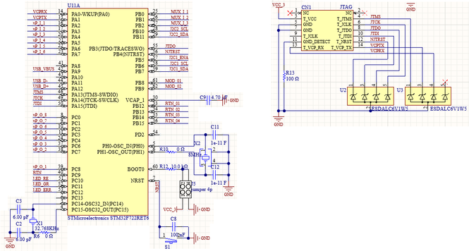

Hello everyone,

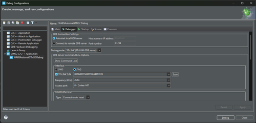

I've been looking for some time for an example of an electronic design that would allow me to use the STLINK-V3MINIE in JTAG mode.
With my electronic schematic I can use it in SWD mode, which works very well.

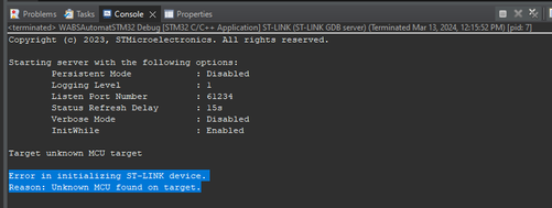

However, it's impossible to use JTAG mode, because when I configure the debugger in STM32CubeIDE and start debugging I get:
"Error in initializing ST-LINK device. Reason: Unknown MCU found on target."

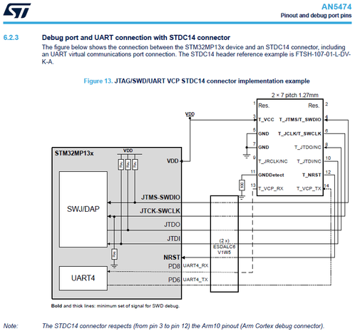

I wonder if my electronic diagram is correct, even if I refer to the AN5474 documentation on page 26.
Could someone either correct my circuit diagram or explain how to make the JTAG work?

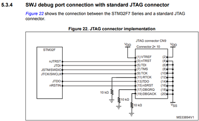

I suggest you to refer to the part 5 of the AN4661 and specially the Figure 22. JTAG connector implementation which shows the connection between the STM32F7 Series and a standard JTAG connector. The one that you are using is for the STM32MP13 series.

That said, document AN4661 does not use the STDC14 connector, nor does it contradict my electronic assembly (chap. 5.3.4).

The only thing is that my 100 ohm "GND_DETECT" resistor doesn't exist.
So why isn't it working?

Why doesn't my schematic allow the use of JTAG?
