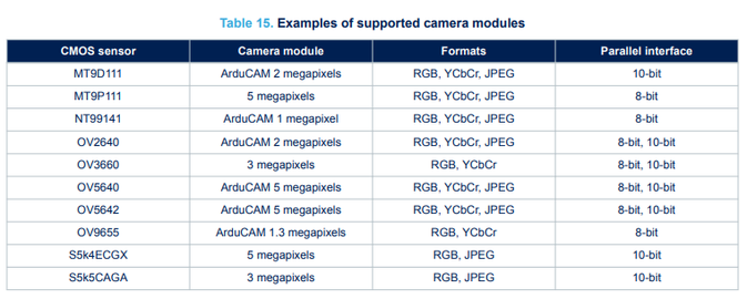

Hello @blurry and welcome to the community;
To know if a CMOS sensor (a camera module) is compatible with the DCMI or not, the user must check the following points in the CMOS sensor specifications:
• Parallel interface (8-, 10-, 12-, or 14-bit)
• Control signals (VSYNC, HSYNC, and PIXCLK)
• Supported pixel clock frequency output
• Supported data output
The AN5020 mentioned some examples of supported camera by STM32 DCMI.
There is a wide range of camera modules and CMOS sensors that are compatible with the STM32 DCMI.
The table below lists some of them.
I recommend you to look at AN5020 "Introduction to digital camera interface (DCMI) for STM32 MCUs".  This application note gives to the STM32 users some basic concepts, with easy-to-understand explanations of the features, architecture, and configuration of the DCMI. It is supported by an extensive set of detailed examples.
I hope this help you.
Thank you.
Kaouthar
