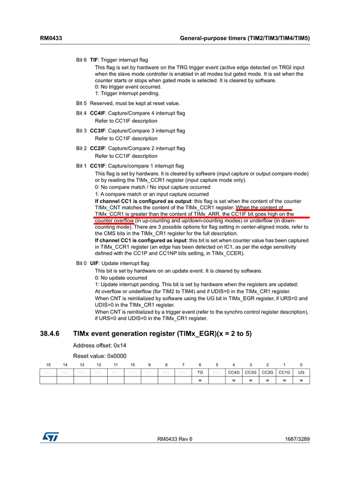

Effect of timer CCR not in range 0
  • February 27, 2020
  • 904 views
DMA requests are still generated if the CCR is outside the auto-reload range
The DMA request is is generated when CNT reaches 0 rather than being disabled.
Processor is a STM32H750
is this a bug or a feature - it should be documented anyway

This is a known, documented, albeit admittedly surprising behaviour (it has been discussed on this forum several times).
Note, that DMA requests are consequence of the event which sets the CCxIF flag.

Many thanks +++. It could still be better documented in the next revision of the manual please.
