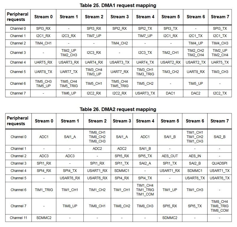

USART2 will be on DMA1, not DMA2

Posted on February 17, 2018 at 00:05
You are the man!!
I know there had to be that table somewhere.  What document did that come out of?  I looked in the data sheet for the STM32F722 and it's not there.
Thanks!!!
Posted on February 17, 2018 at 00:27
This is out of the Reference Manual (RM0431)
http://www.st.com/content/ccc/resource/technical/document/reference_manual/group0/c8/6b/6e/ce/dd/f7/4b/97/DM00305990/files/DM00305990.pdf/jcr:content/translations/en.DM00305990.pdf
