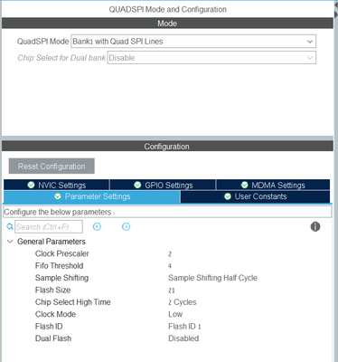

Hi, I'm trying to add an external memory and i choose that chip because it can communicate with QSPI and there is no need for designing due the chip is SOIC-8 which i found a compatible board for it.
I'm getting issues with the driver writing i'm getting all the time a hard fault or infinite loop. i use chatGPT for the driver writing because i didn't found any written one.
My QUADSPI configuration:
This is the driver:

When i'm getting into HAL_StatusTypeDef QSPI_EnterQPI(QSPI_HandleTypeDef *hqspi) function
i get stuck in this function:
static HAL_StatusTypeDef QSPI_WaitFlagStateUntilTimeout(QSPI_HandleTypeDef *hqspi, uint32_t Flag,
FlagStatus State, uint32_t Tickstart, uint32_t Timeout)
/* Wait until flag is in expected state */
while((__HAL_QSPI_GET_FLAG(hqspi, Flag)) != State)
/* Check for the Timeout */
if (Timeout != HAL_MAX_DELAY)
if(((HAL_GetTick() - Tickstart) > Timeout) || (Timeout == 0U))
hqspi->State = HAL_QSPI_STATE_ERROR;
hqspi->ErrorCode |= HAL_QSPI_ERROR_TIMEOUT;
return HAL_ERROR;
return HAL_OK;
which i don't understand why
Someone can help me?

Hello @Ditzhak ,
Could you please take a look at this FAQ How to debug a HardFault on an Arm Cortex®-M STM32 may help you to debug the HardFault.
Also, I advise you to refer to this post "Solved: STM32U5A5: PSRAM (4MB external RAM) via QSPI (OCTO... - STMicroelectronics Community"  and check the OCTOSPI configuration (the chip used : IS66WVS4M8ALL) and AN5050.
Thank you.
Kaouthar
Please use the </> code formatter to post code, please edit your post and fix
You have to Memory Map the QSPI for it to be able to access memory at 0x90000000, otherwise you'll get Hard Faults if you touch it.
ChatGPT is not paid to do the job of the Embedded Software Engineer, you might want to read the manuals to understand how things actually work..
Pavel A.
Which STM32H7? Does it have Octo-SPI or only QSPI?
STM32H753 - have only QSPI
QSPI cannot write in memory mapped mode, as you probably know.
