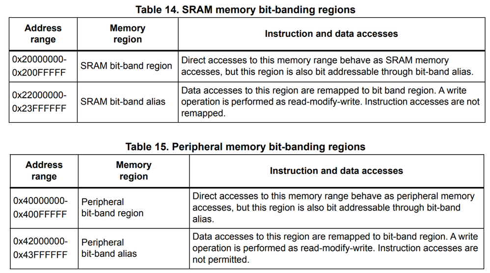

Does STM32L431 support bit band operation
HSX.1
What are the SRAM bit band area address and its bit band alias area address, and the peripheral bit band area address and its bit band alias area address, if supported?

Bit banding addresses are shown in the programming manual. Not everything is bit banded.
Source:
https://www.st.com/resource/en/programming_manual/dm00046982-stm32-cortexm4-mcus-and-mpus-programming-manual-stmicroelectronics.pdf

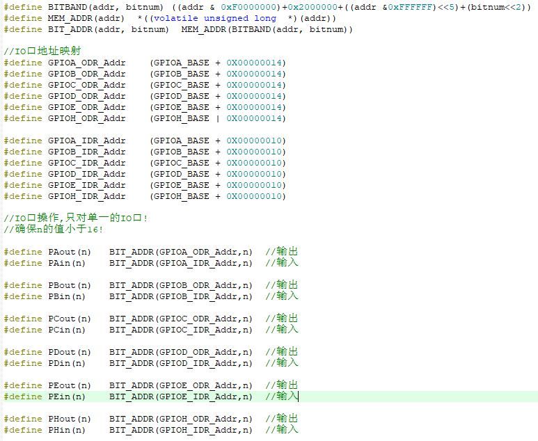

"Does STM32L431 support bit band operation?" - yes (it does)
Have you ever used the bit band operation of STM32L431?
So, are the GPIO addresses within the area which is bit-banded (see TDK's post above)?
