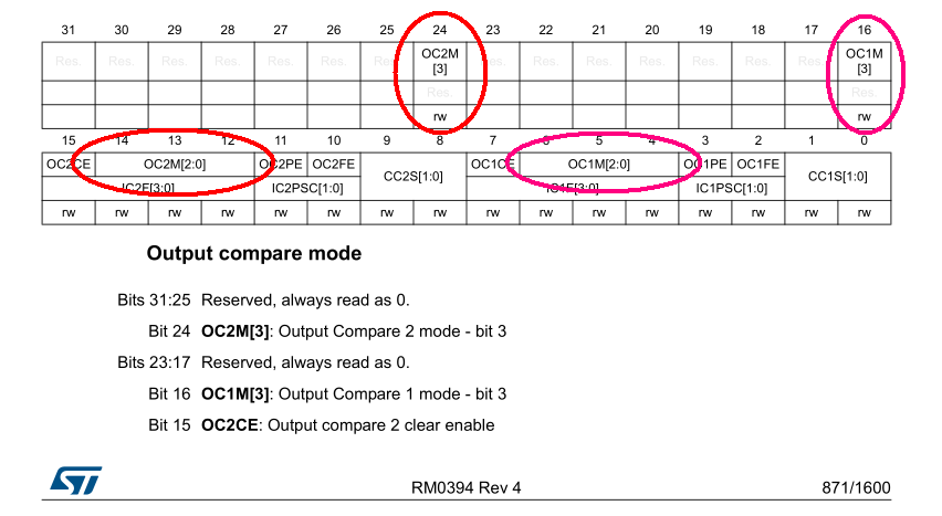

I'm unsuccessfully trying to put STM32L412 TIM2 output comparator into combined-PWM mode via the STM32CubeIDE (ioc GUI). Can I confirm that this functionality exists in this device and for this particular timer? And if it does, is there a trick for making it appear as a selectable option in the IDE? I can see Combined PWM options for this timer but they all seem to relate to timer input rather than timer output.

There is nothing in RM0394 which would indicate that the 'L412 would not have Combined PWM modes available in TIM2, see TIMx_CCMRx description of TIM2/TIM3 chapter. Also I don't think there is anything which would link Combined PWM with Input Capture.
Instead of fighting the clicky IDE, you can try to program this directly in registers. Timers are not that complicated.

For starter, you can try to configure the two neighbouring channels independently for plain PWM in the clicky, and then manually overwrite TIMx_CCMRx_OCxM of one of them for the Combined PWM mode. For extra fun, you can do this without writing any code, simply in the debugger, while observing the effect on the output pins.
Note, that the OCxM field is for historical reasons non-continuous
