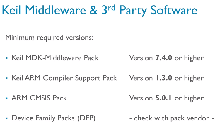

migrate Compiler 5 -> Compiler 6 in KEIL MDK.
https://www.youtube.com/watch?v=rt6tD0ffYIk&index=2&list=PLgfqWPj3VNU-5luCbv1Y-gutHx7aNXb9p&t=0s
I am using STM32F1 DFP, I install the latest one. It seems don't work with Compiler 6 now.
So, STM32 pack vendor designers, and I right?
#dfpSolved! Go to Solution.

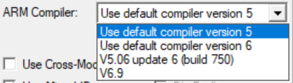

‎2018-03-03 11:46 PM
Hello
Arm Compiler 5 (AC 5) is the legacy ARM compiler that has been shipping for many years. It will continue to be supported.
Arm Compiler 6 (AC 6) is LLVM based and as such some modifications might be needed to port from AC5.
See
http://www.keil.com/support/man/docs/uv4/uv4_dg_armclang_cmp.htm
At some point in time the examples in the packs will be made for just AC6.
AC6 supports the new ArmV8-M Cortex-M23 and Cortex-M33 - not AC5. So these examples are written for AC6.
Most versions of MDK currently ship with both AC5 and AC6. You can select either one:
Keil and ST do work very closely on the Packs and STM32CubeMX.
Thanks
Bob Boys

I think you need to ask this question on the Keil forum, the device packs fall into their responsibility.
Maybe a Keil user present here knows too ...
