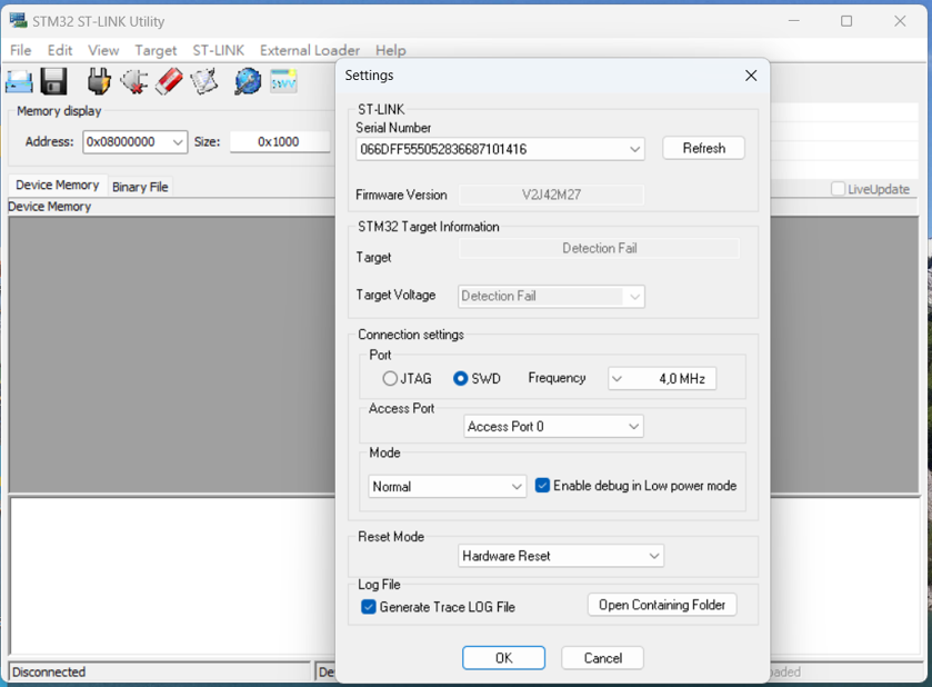

We are trying to use software "STM32 st-link utility" to program stm32h563 series MCU.
However, it could not recognize our target MCU and shows "no target connected".
Stm32h563 Target not connectedStm32h563 Target not connected

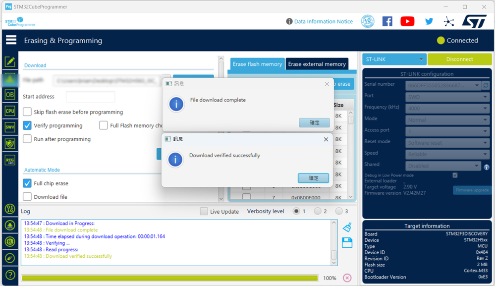

The SWD pin connections are correct, we are able to do programming with software "STM32CubeProgrammer" :
(Same device and same environment)
Stm32h5_upgrade_programmerStm32h5_upgrade_programmerDoes software "STM32 st-link utility" support programming Stm32H5 Series MCU?

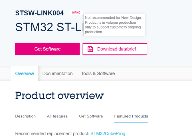

The STM32 ST-Link Utility was deprecated many years before the STM32H5 series even came out. I wouldn't expect any updates.
2 REPLIES 2
KDJEM.1
Hello @BRIAN_LAI ,
STM32 ST-LINK utility: Not recommended for new design. Product is in volume production only to support customers ongoing production. Recommended replacement product: STM32CubeProg
Thank you.
Kaouthar
