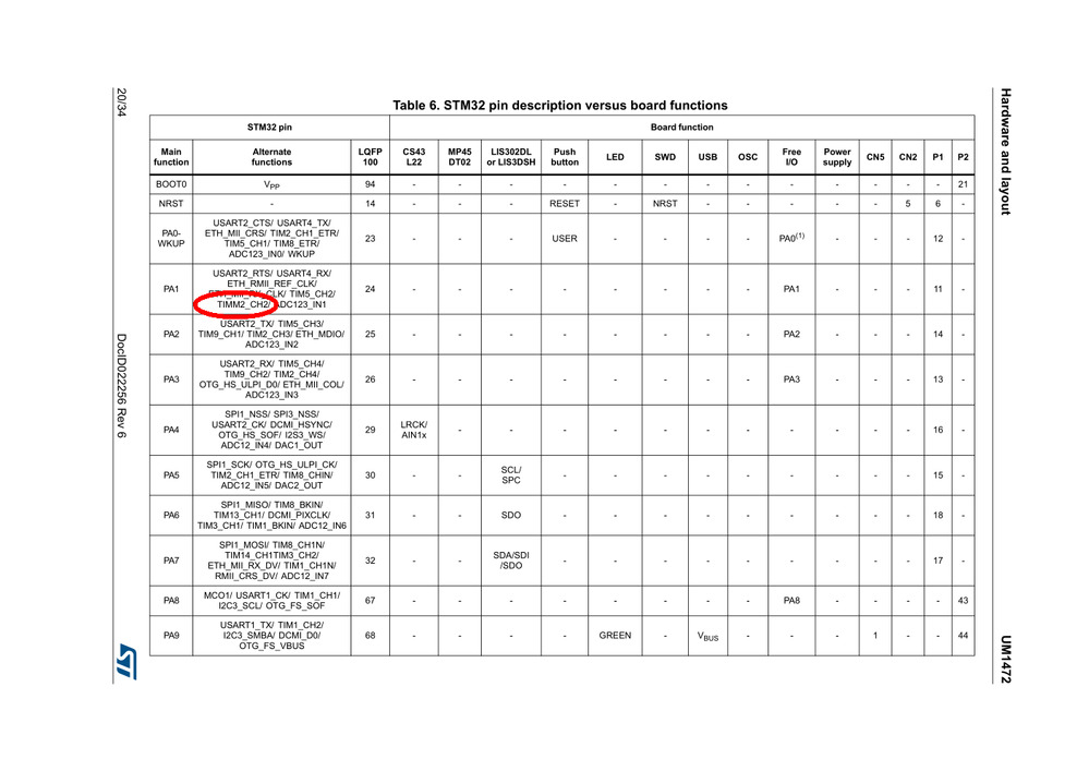

Posted on July 24, 2017 at 14:37
There's a typo in Table 6:
Posted on July 26, 2017 at 16:16
Hi Jan,
Thanks for bringing this to our attention
This is highlighted internally and will be fixed in next releases.
Khouloud.

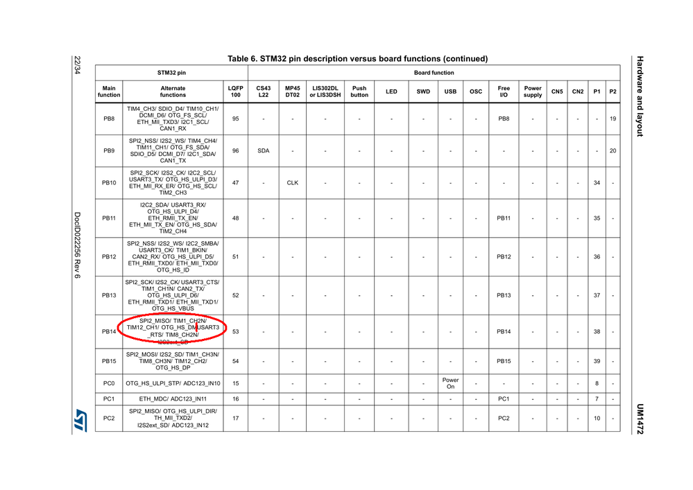

Posted on October 06, 2017 at 15:34
One more:
OTG_HS_DM and USART3_RTS stuck together there.
