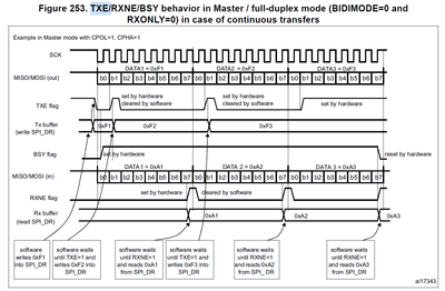

I guess you're right. I really though it could be 32-bits on the F4, but maybe I've been using the H7 too much lately. I guess you could chain the second transfer off of the TC trigger without too much trouble or delay.
What you wrote will probably work okay if the SPI clock rate is high, but just because TXE=1 the transmission may not be complete. You should wait for BSY=0 after the final transfer before you pull CS high.
