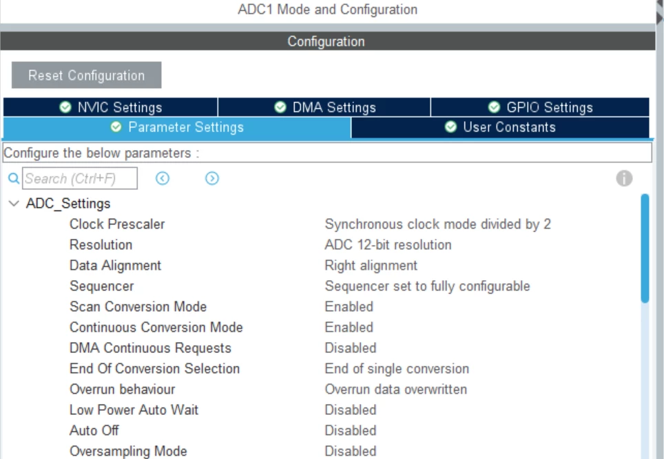

I have seven ADC channels in my design. I have probed these channels and can confirm from an analog standpoint the signals are clean, and are stable when read from using the ADC.
I have read from each channel and received expected values, however when I scan, I at times will have a channel reporting a value I would expect from a different channel. As if I am reading from channel 4, but it is reported as channel 5. Here is telemetry I receive when reading from the ADC channels:
... Beginning ADC Read ...
VIN Voltage [mv]: 6190 index: 1
3V3 Voltage [mv]: 446 index: 2 // I would expect this value on a CC line
CC1 Voltage [mv]: 51 index: 3
CC2 Voltage [mv]: 1236 index: 4 // I would expect this value to be VBAT
IBAT Current [mV]: 1236 index: 5 // same value again ??
VBAT Voltage [mv]: 2476 index: 6
My implementation for scanning and reading these ADC channels is below:

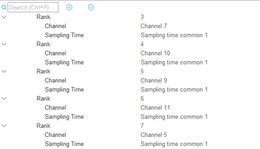

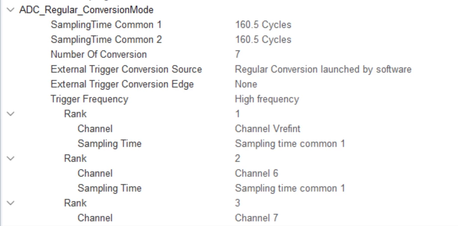

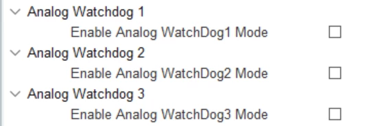

jesseTP_0-1718376627975.pngjesseTP_1-1718376663997.pngjesseTP_2-1718376700530.pngjesseTP_3-1718376721357.png
I am not using the DMA in this instance for some minor power savings. Could this be the cause of my issue? Anything else stick out for what I am doing wrong?

Lohi
