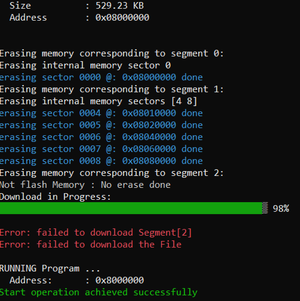

I use CLI for flash F469 and same hex file flashed over SWD without error produce over DFU this. 0693W00000YAhtuQAD.pngis this know issue ? Seems code is ok after both loads.
I test HEX and ELF file, and seems here linker generate section , but same file dont produce error if -c SWD is used.

and i dont understand why this section is in . Maybe my linker file need add somethink i use CCMRAM for some arrays. now is defined as
/* Memories definition */
MEMORY
  FLASH0 (rx)      : ORIGIN = 0x08000000, LENGTH = 16K	/* FL1 zatial isr */
  CCMRAM    (xrw)    : ORIGIN = 0x10000000,   LENGTH = 64K
  RAM    (xrw)    : ORIGIN = 0x20000000,   LENGTH = 320K
  FLASH    (rx)    : ORIGIN = 0x8010000,   LENGTH = 1984K /* reserve EEPROM sec 1 2 3 used only 2 3*/

Where's the data going?
SRAM at 0x20000000. CCMRAM at 0x10000000
There shouldn't be any of that in the .ELF file / sections, as the startup.s code should be copying initialization data out of Internal FLASH
What other sections is the DFU file describing?
MEMORY
/* Sections */
SECTIONS
/* Added MM */
  .ccmram :
    . = ALIGN(4);
    _sccmram = .;       /* create a global symbol at ccmram start */
    *(.ccmram)
    *(.ccmram*)
    . = ALIGN(4);
    _eccmram = .;       /* create a global symbol at ccmram end */
  } >CCMRAM
    /* The startup code into "FLASH" Rom type memory */
  .isr_vector :
    . = ALIGN(4);
    KEEP(*(.isr_vector)) /* Startup code */
    . = ALIGN(4);
  } >FLASH0
... rest no changes
