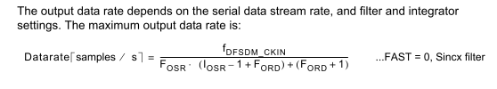

Regarding the data rate in injected mode:
Maximum output data rate exact formula is written in reference manual:
This formula gives for your configuration (3MHz, FOSR=32, FORD=3, IOSR=1):
3MHz/(32*(1-1+3)+(3+1))=30kHz
So - the maximum output data rate is 30kHz. If you are using multiplexing of 2 channels then it will decrease to 15kHz per one channel. But this sampling rate is calculated as theoretical maximum - because there is not continuous mode in injected conversions. So - just after one conversion finishes then there must be initiated trigger to perform next conversion. One way is to configure one filter in injected
scan
mode and in the scan group will be 2 channels. The configuration will be JSCAN=1   =>  for one trigger is performed in continuous mode whole scan group (all channels for one trigger as fast as possible). But then must be initiated trigger (usually timer trigger) to start next couple of conversion. Second way (and better for your application) is to use JSCAN=0  =>  for one trigger is performed only one conversion from scan group (one channel converted) and to perform next conversion (next channel in scan group) is needed to initiate next trigger. This second configuration can be slower - because timer trigger must be initiated after previous conversion finished + some margin to be sure. But advantage of second configuration is equidistant interval between each samples - because only timer trigger defines the time between samples (and there is not conversion after conversion and then waiting for trigger - like in first case).
 You reported 2kHz output sampling rate - this is too slow. Which type of trigger are you using. Try to set the timer trigger for ~10kHz rate - this should be safe value for the theoretical maximum (30kHz) data rate for your configuration (FOSR=32, FORD=3, Fclkout=3MHz).
