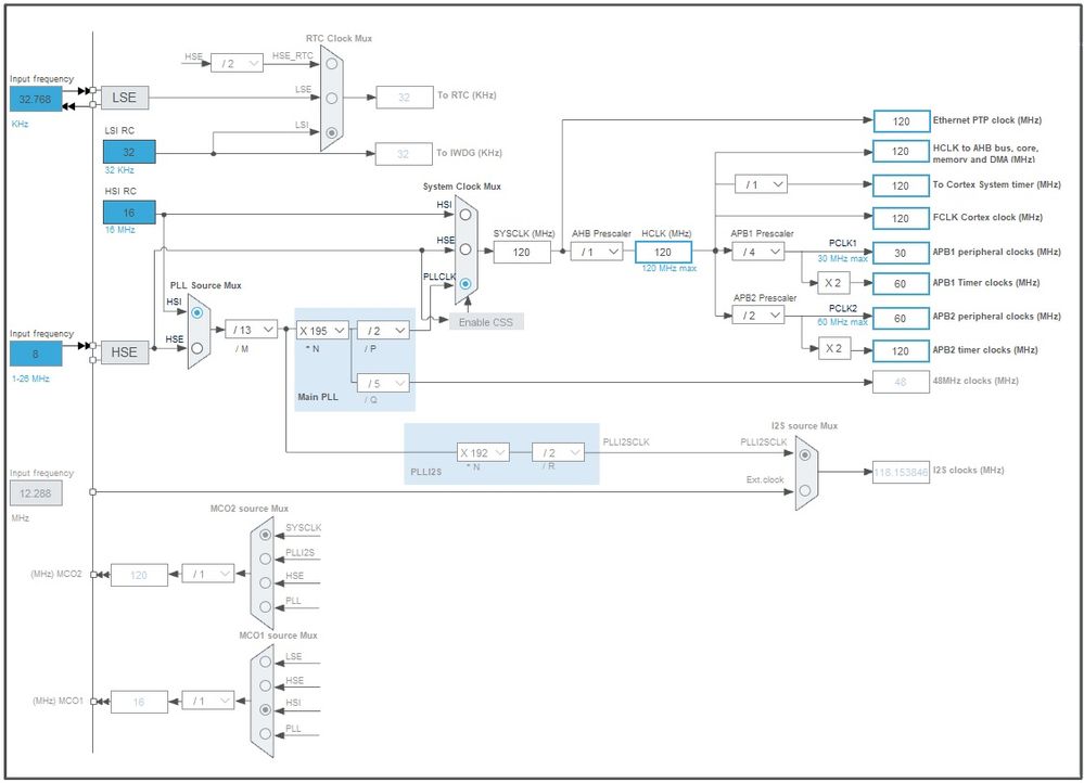

Ok. Now i am using pwm generator and feeding it to PA0 pin of STM32F207ZG nucleo board. I want to measure 1 HZ to 80KHz frequency...
The timer clock settings are as below

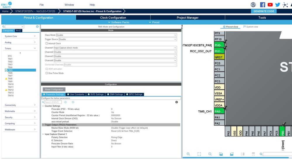

0693W00000BatwVQAR.jpgBelow is my timer5 setting..
0693W00000BauC9QAJ.jpgBelow is my interrupt code to measure the difference between two rising edge...
void HAL_TIM_IC_CaptureCallback(TIM_HandleTypeDef *htim)
	if (htim->Channel == HAL_TIM_ACTIVE_CHANNEL_1)
		if (Is_First_Captured==0)
			IC_Value1 = HAL_TIM_ReadCapturedValue(htim, TIM_CHANNEL_1);
			Is_First_Captured =1;
		else if (Is_First_Captured)
			IC_Value2 = HAL_TIM_ReadCapturedValue(htim, TIM_CHANNEL_1);
			if (IC_Value2 > IC_Value1)
				Difference = IC_Value2-IC_Value1;
			else if (IC_Value2 < IC_Value1)
				Difference = ((0xffffffff-IC_Value1)+IC_Value2) +1;
			else
				Error_Handler();
			Frequency = HAL_RCC_GetPCLK1Freq();
			Frequency = Frequency / Difference;
			Is_First_Captured = 0;
The problem is that it is showing almost half the frequency and the accuracy is also low. Suppose for 100Hz input pulse it shows me 48 Hz. Any idea where i am going wrong and how to improve the measuring accuracy ?

waclawek.jan
June 14, 2021
What is "internal crystal"? HSI? If yes, it's not very precise, see datasheet.
If you use a non-1 APB divider, the timer's clock is twice as much as APB clock, see RCC chapter of RM.
