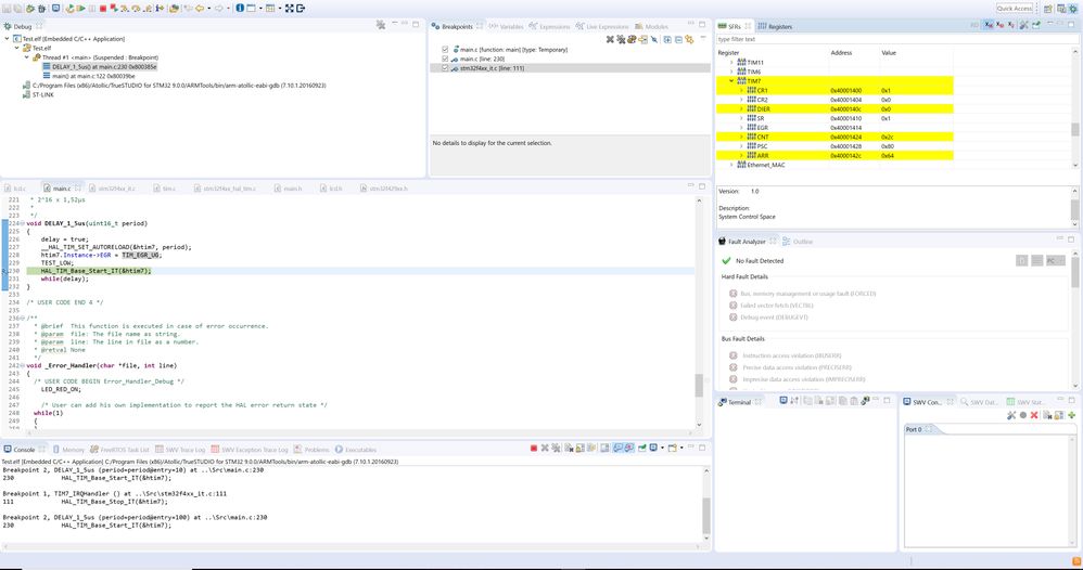

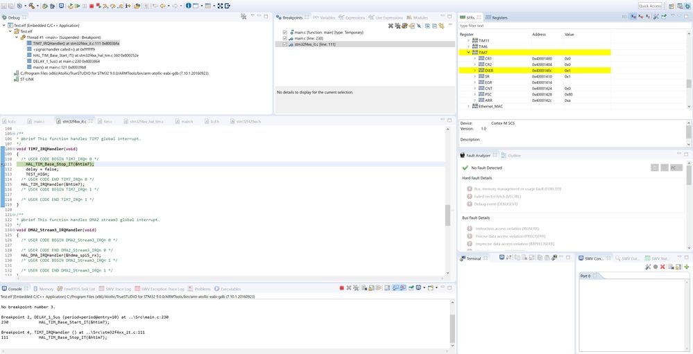

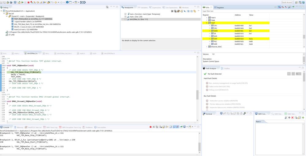

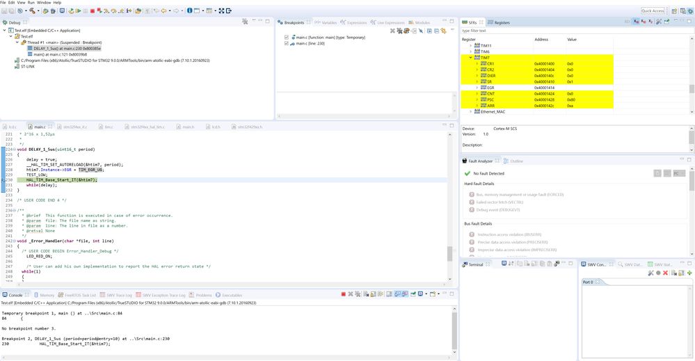

‎2018-04-30 3:51 AM
Hey JW,
see attached the screenshots from the registers:
First I issued a delay of 10 x 1,5µs so the ARR is 10. This screenshot is when the MC processes the function call:
Here is the screenshot of the first ISR entering (10x1,5µs):
When I issue a second delay right after with 100 x 1,5µs it seems as if the counter doesn't start from zero, but the last value after I stopped it in the ISR. Possible this might be the error I am facing?
Inside ISR (100 x 1,5µs):
