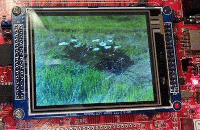

Guys,
Does anyone of you have experience on decoding bmp ?
I want to display bmp file to my LCD...
Any clues ?

Ok, I have the manual for the SSD part, do you have any manual/documentation/schematics for the BOARD you are using?
Can you see and image of the flowers, but with the wrong colours? I can't make out anything through the flash glare.
Perhaps you have some #defines for RED, GREEN or BLUE colours passed to the functions you are using? Or a cite to the library/code?

Yes I can see flower but the color is not right,
Yes I have define :
#define Blue 0x001F
#define Red 0xF800
#define Green 0x07E0
I attached the schematic, please check it out, thanks

Posted on April 18, 2014 at 15:08
// RRRRRRRRGGGGGGGGBBBBBBBB 8:8:8
// RRRRRGGGGGGBBBBB 5:6:5
pal = ((pal & 0xF80000) >> 8) | ((pal & 0x00FC00) >> 5) | ((pal & 0x0000F8) >> 3);

Thanks for the info,
May I know how can you get those values ?

I tested and it gave me the same result, only the color was changing to blueish...
do I miss something here ?
I'm attempting to translate the colour space formats.

From my SSD1298 panel

Posted on April 19, 2014 at 00:59
I'm using SSD1289, is it the same with SSD1298 ?
Here's the complete function I used
