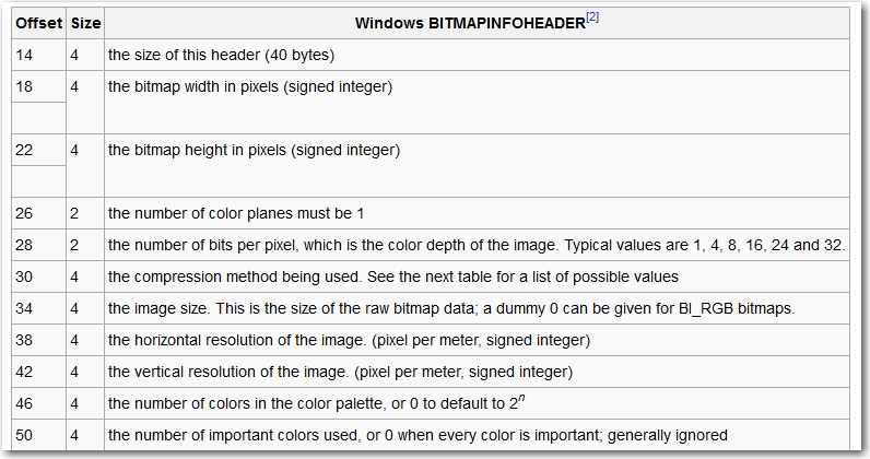

offset 18  size = 4 bytes,
the bitmap width in pixels (signed integer) but in code : it's offset 12, or I'm wrong ?
 xx = *((uint32_t *)&hdr[0x12]); // X pixels (want multiple of 8)
do you mean the LCD ? it's SSD1289, and it's RGB..
I can see from the file the value of offset 12 until 15 are 40 01 00 00 which mean 320...that's correct but from wiki it's saying at offset 18, so it's not right....
antonius
Senior
Posted on April 18, 2014 at 06:49
my mistake, 0x12 HEX = 18 DEC....

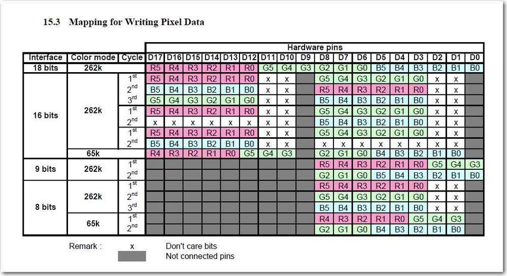

Ok, but what's the word format? How are the R,G,B colour bits distributed across the word?
The SSD1289 is a controller chip, what's the part# of the display, cite a manual down load for the board you are using.
antonius
Senior
Posted on April 18, 2014 at 07:14
I send data from D0-D16....
The RGB will be distributed at D0-D16....is that what you're asking ?
Posted on April 18, 2014 at 07:52
I send data from D0-D... The RGB will be distributed at D0-D...is that what you're asking ?
FFS I'm trying to understand where the colour bits are within the 16-bit word, is this a hard concept to grasp? I ask for the datasheet for your panel so I can figure it out. I'll make an educated guess at the 5:6:5 format

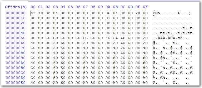

I have 2x2 pixel 8 bit bmp,
where is the first byte of the pixel ?
offset 0x12 = 2 (width ) offset 0x16 = 2 (height), offset 0x1C = 8 bit ( color of 8 bit ), index color is starting from offset 0x3E = 00 ?
the picture (zoomed 200x) the actual size is 2x2 pixel:

Ok, please have a look for the datasheet attached...thanks
________________
Attachments :
SSD1289.pdf : https://st--c.eu10.content.force.com/sfc/dist/version/download/?oid=00Db0000000YtG6&ids=0680X000006I1AF&d=%2Fa%2F0X0000000bks%2FuWxfwu0qkcAquqQZOG95p3JmEiE_tLIqkOFouzUIUis&asPdf=false
antonius
Senior
Posted on April 18, 2014 at 11:13
is it the one you look after ?

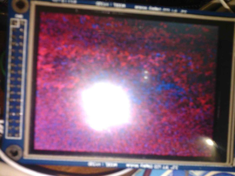

I tried
and on LCD :
What should I change on pal ?
 pal = ((pal & 0x00FC00) >> 5) | ((pal & 0xF80000) >> 19) | ((pal & 0x0000F8) << 8);
