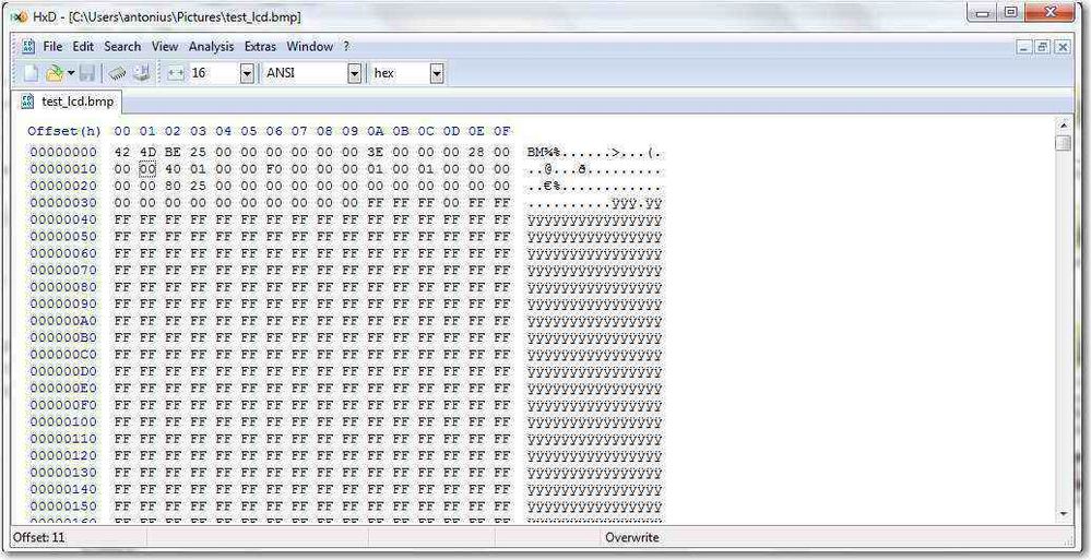

Posted on April 12, 2014 at 14:13
The picture data begins are 0x3E (62)
You'd need to decode the bit stream, describing each line, into a pixel format suitable for your display. It's a monochrome image, black/white going by the RGB palette.

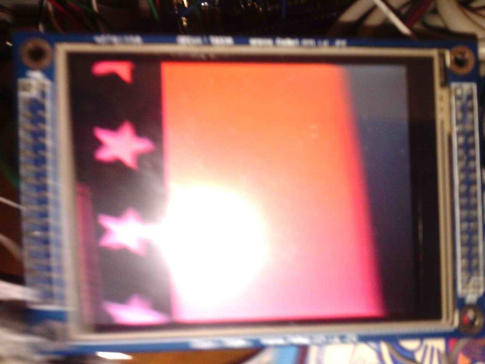

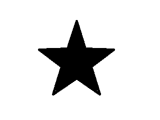

I modify a little bit,
f_seek(&fsrc, 0x3E, F_SEEK_SET); // Seek to the data <== I can't find SEEK_SET so I commented out, It can display bmp but smaller and 4 times, do I miss something in the loop ? suppose to be : 0690X00000602Q0QAI.bmp I got : 0690X00000602tHQAQ.jpg
LCD_SetCursor(0,0);
res = f_open(&fsrc, ''test1.bmp'', FA_READ);
//f_seek(&fsrc, 0x3E, F_SEEK_SET); // Seek to the data
//f_lseek(&fsrc, 0x0A);
for(y=0; y<320; y++)
for(x=0; x<240; x+=2) // advance 8 pixels (one byte of bits)
uint8_t b;
UINT bytesread;
f_read(&fsrc, &b, 1, &bytesread); // Read byte
for(i=0; i<8; i++) // Process bits in byte, MSB first
if (b & 0x80) // Pixel On?
LCD_SetPoint(x+1, y, 0x0000); // Colour
else
LCD_SetPoint(x+i, y, 0xF0F0); // Black
b <<= 1;
} // x
} // y
f_close(&fsrc);
