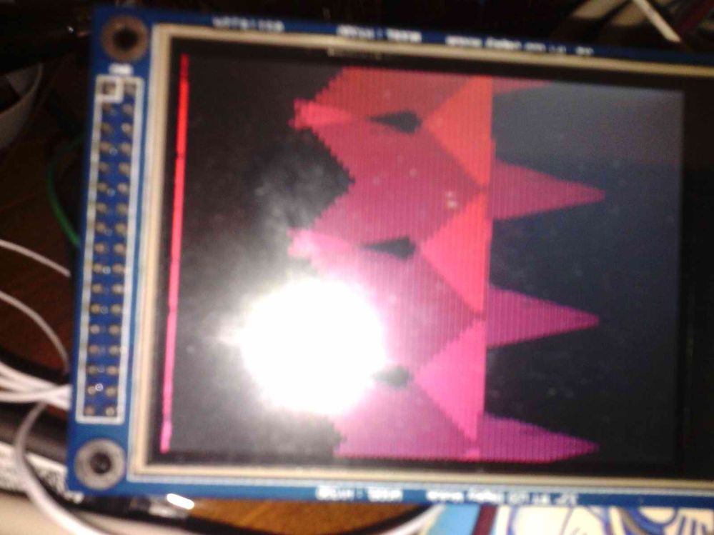

if I used
1.
for
(y=0; y<320; y++)
2.
3.
for
(x=0; x<240; x+=8)
// advance 8 pixels (one byte of bits)
I got : 0690X00000602tMQAQ.jpg Do you have a clue ? thanks

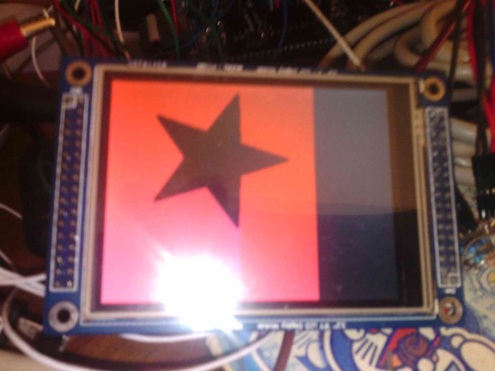

Posted on April 17, 2014 at 17:25
Got the x/y sizes switched
// a more general solution would read dimensions from header
// and handle errors, etc.
// For the specific BMP, 1-bit per pixel, 320x240
int i, x, y;
res = f_open(&fsrc, ''test.bmp'', FA_READ);
f_lseek(&fsrc, 0x3E); // Seek to the data
for(y=0; y<240; y++)
for(x=0; x<320; x+=8) // advance 8 pixels (one byte of bits)
uint8_t b;
UINT bytesread;
f_read(&fsrc, &b, 1, &bytesread); // Read byte
for(i=0; i<8; i++) // Process bits in byte, MSB first
if (b & 0x80) // Pixel On?
LCD_SetPoint(x + i, y, 0x0F0F); // Colour
else
LCD_SetPoint(x + i, y, 0x0000); // Black
b <<= 1;
} // x
} // y
f_close(&fsrc);
int i, x, y, xx, yy;
uint8_t hdr[0x28];
UINT bytesread;
f_read(&fsrc, hdr, sizeof(hdr), &bytesread); // Read header
xx = *((uint32_t *)&hdr[0x12]); // X pixels (want multiple of 8)
yy = *((uint32_t *)&hdr[0x16]); // Y pixels
for(y=0; y<yy; y++)
for(x=0; x<xx; x+=8) // advance 8 pixels (one byte of bits)
uint8_t b;
else
b <<= 1;
} // x
} // y
f_close(&fsrc);
antonius
Senior
Posted on April 18, 2014 at 03:59
Thanks a lot, it works for the star, but why isn't it finished to the end of the screen ?0690X00000602tRQAQ.jpg

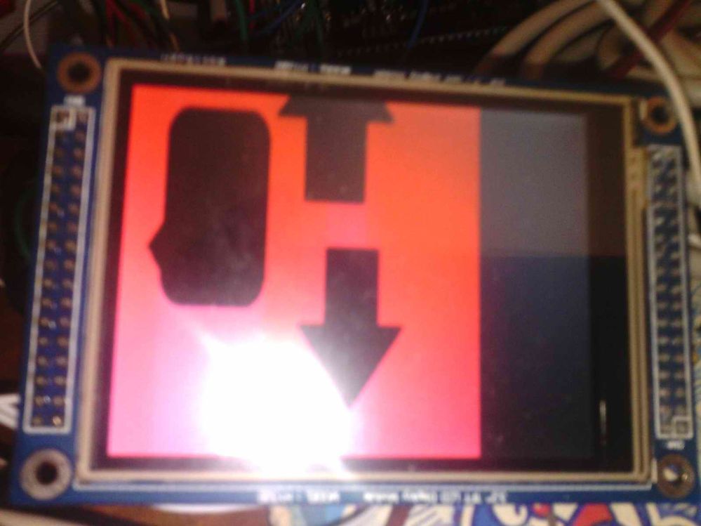

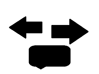

I tested with different picture, it seems that the x/y is reversed ?
originally :
on lcd :
antonius
Senior
Posted on April 18, 2014 at 04:20
fixed :
for
(i=0; i<8; i++)
if
(b & 0x80)
// Pixel On?
LCD_SetPoint(y, x+i, 0xF0F0);
// Colour
else
LCD_SetPoint(y, x+i, 0x0000);
// Black
b <<= 1;
