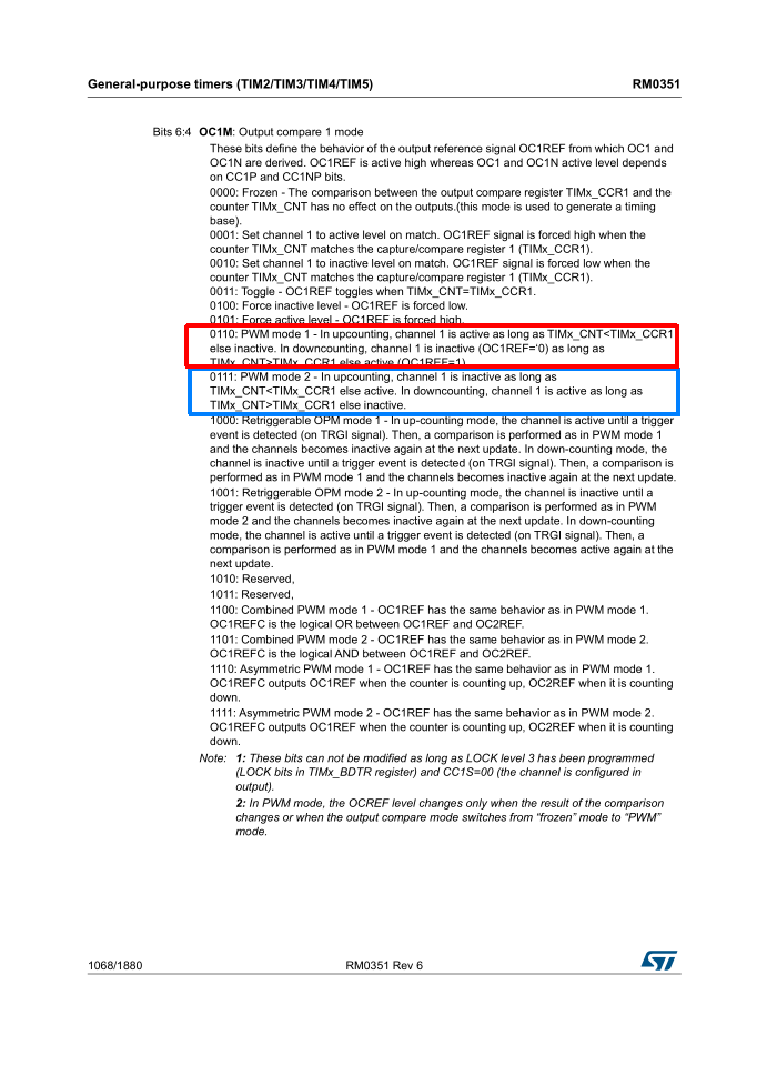

Dear Colleagues, I'm getting to know the STM32L476RG uC on a Nucleo board. I do not find the answer, what is the difference between PWM mode 1 and PWM mode2 of the TIM2 module?

Thank You Jan, You're quick ;)
I thought there's some more relevant difference. However, I haven't found this particular one in the refmanual before.
Thanks again!
