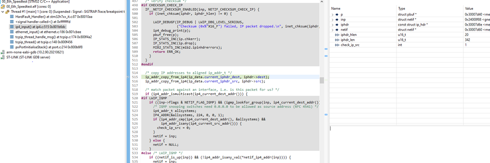

I'm using STM32H743ZI2 Nucleo board to connect to internet but I have a hard fault error.
I'm try enable MMARVAILD bit in SCB->CFSR to hold valid fault address (SCB->CFSR |= (0X1UL<<7);) but it's still 0 after set command.
Please help me to check error

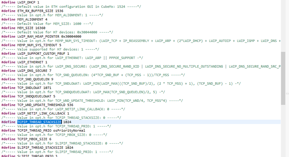

linker file
.lwip_sec (NOLOAD) : {
. = ABSOLUTE(0x30000000);
*(.RxDecripSection)
. = ABSOLUTE(0x30000200);
*(.TxDecripSection)
. = ABSOLUTE(0x30004000);
*(.Rx_PoolSection)
} >RAM_D2
error: LWIP config

Use the hard fault analyzer tool in CubeIDE, it will show you all available details.
This bit is read only,
