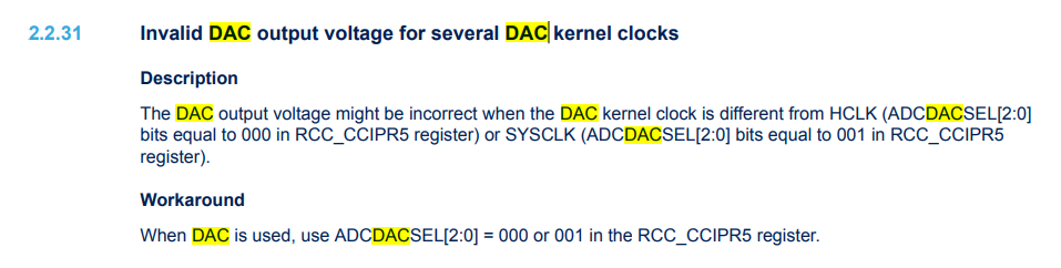

My problem: how to configure DAC so that CPU core clock and DAC kernel clock can be asynchronous (i.e: 250MHz and 70MHz)?

- results:
- when DAC is clocked by HCLK (ADC,DAC Clock Mux = HCLK): OK :)
=> output is toggling with a rectangle frequency of 24kHz (as expected)
- when DAC is clocked by PLL2 (ADC,DAC Clock Mux = PLL2R): KO :(
=> output is randomly toggling
My feeling is that the transfert of the DAC out value (DHR12L1 register) does not work if clocks (CPU and DAC ones) are asynchronous. Can you help me?

Hello @jeremierafin ,
First of all, I wanted to thank you for your detailed explanation and outstanding detailing of this issue.
after examination of the code and after double-checking the tests that you did i share your assumption about this being a silicon bug most probably related to the STM32H562xx/563xx/573xx device errata - Errata sheet
I submitted a ticket (ticket number 200203 for internal reference only) to confirm this erratum is valid for H523 series as well and will keep you updated.
Regards
This has been confirmed as limitation and will be updated in upcoming Errata revisions. Thank you for pointing this out.
Regards
2025-01-29 2:34 AM
To conclude: the DAC CAN NOT be clocked by PLL2R (silicon bug).
