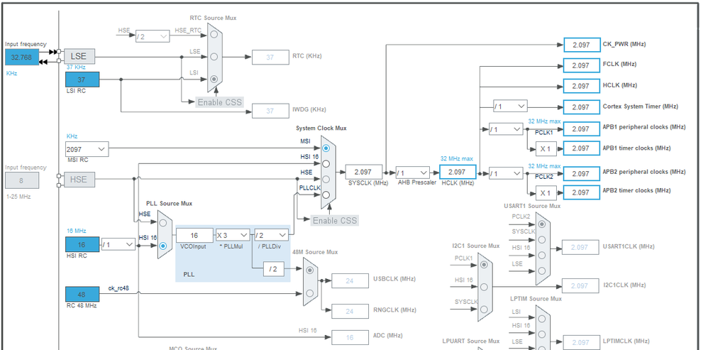

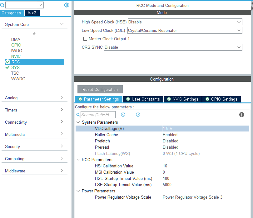

A have a problem with power consumption, when I try to put the microcontroller in low power sleep, the current consumption is around 8.5mA, when I expect around 20uA.
I'm using a custom board, but only a single LED is connected, capacitors and a 32kHz (P/N recomended by ST).
I tested in Sleep and Stop mode (with low power regulator), changed the clock to MSI in 100kHz, without the ST-Link connected, Serial Wire Debug deactivated, and nothing :(
Only in standby mode i get 2uA of current. Please a need hekp around this situation :)
Below I will post a print of clock configutarion and a snap of code, peripherals enable os only de TIM7 for the SysTick. (I don't know why, if I use the default Systick, i get hardfault when try to enter in sleep mode).
Code to reconfigure the Clock:
