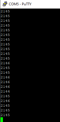

The thing is, after setting ADC1 for differential mode, the value I get after measuring one capacitor is of 2155 (1.74V), which is way higher than it's actual charge (0.17V, measured manually).

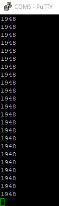

I thought that maybe I had missplaced the pins, so I swaped them and I got 1937 this time. Funny enough, 2155 - 1937 = 218, which is exactly the 0.17V that I'm expecting when converted, so I know that I can't be too far from the solution.
And here is what i receive through terminal:0693W000008zfzJQAQ.pngAnd after switching the pins:

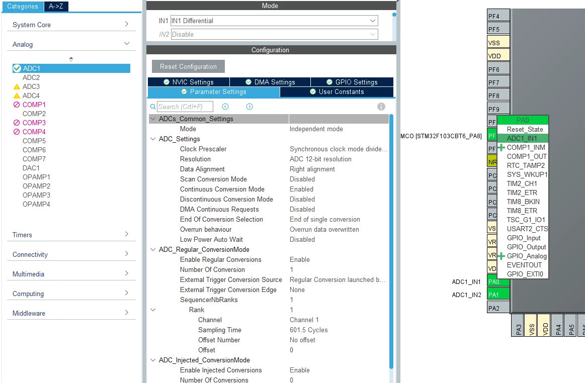

Here is an screenshot of my configuration and I also include the main.c code, but the only things that I've included after auto generating are:

What is common mode voltage? Differential mode has only a small window around VREF/2., see table 79 CMIR.

Common mode voltage is ( V(ADCIN+, referenced to ground) - V(ADCIN-, referenced to ground)). It seems your setup has no ground connection between Nucleo and "CAP" board, so common mode voltage is floating and perhaps strange things happen. Try to measure single-ended: Connect to lower vltage of the CAP board to MCU GND and the higher voltage to ADCIN. Read about common-mode, single ended etc also in the Internet.

Ok, I've tried single-end ADC before, using pins to AGND and to PA0, and it works fine. I've measure the voltage of each pin used at the differential measure and their difference is the voltage that I'm looking for, but I'm trying to get said value with just one measure.
Also, could this MC be able to measure a diffential voltage when one of the pins is at, say, 48 and the other at 46? Or would voltages that high affect the board /MC?

No. ADC absolute voltage needs to be between VSSA and VDDA or you will fry the chip.
