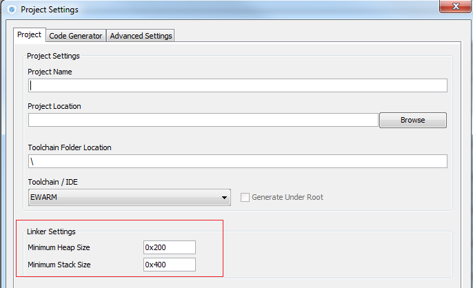

I used STM32CubeMX and configured a project using RTOS and USB_DEVICE (I am trying to run the USB CDC functionality with the FreeRTOS). The program runs until it hits the USB_CoreInit function inside stm32f4xx_hal_pcd.c file and then something bizarre occurs, it hangs and when i hit pause in EWARM the program counter is somewhere random. If i comment out the function the RTOS runs fine but obviously then the USB still doesn't work.
Has anyone had a similar issue?

‎2017-01-20 8:58 AM
Hi
stephen.ryan
,Try to increase heap and stack sizes. Then, please let me know if it is OK with this suggestion.

‌Thank you for your reply,
Is there an option for increasing these in cubeMX? I have tried increasing the stack size for the RTOS task allocated to USB and have also increased the heap and stack size within the linker configuration. I notice that whenever I rebuild the cubeMX project it returns the heap and stack size back to their default value. Is there a minimum heap size for the USB?

‎2017-01-23 3:19 AM
As it turns out it determined the issue was to do with enabling low power mode. I disabled that and it is now working. But it does jump to the vApplicationStackOverflowHook function. Which should I increase? the stack for the RTOS or increase the linker stack information?

Hi
Stephen.Ryan
,Is there an option for increasing these in cubeMX?
maybe you can refer to USB example under the STM32CUBE F4 package : STM32Cube_FW_F4_V1.0\Projects\STM32469I_EVAL\Applications\USB_Device

‎2017-01-23 3:44 AM
A little further investigation shows that it actually isnt hanging, Looking in the call stack I can see that an interrupt handler 'OTG_FS_WKUP_IRQHandler' is invoked whilst in USB_CoreInit, it also shows '<Exception frame>' but when it is in the interrupt handler it tries to call the SystemClock_Config() again which is what is hanging on line: ' if (HAL_RCC_OscConfig(&RCC_OscInitStruct) != HAL_OK)'
‎2017-01-24 3:19 AM
Thank you for your help
ELMHIRI.Syrine
‌, i increased the stack and heap sizes further and the device operates without a driver failed to start error which i was seeing before. The low power mode of the USB seem'd to crash the program, out of interest how would one implement the low power mode? is there a function which should invoke a power up/ low power mode enable?
