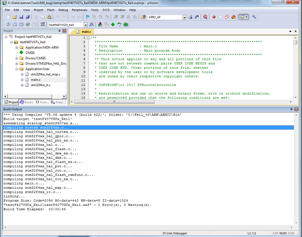

When generating projects for existing MDK V5, the CubeMX produces a second entry for system_stm32f4xx.c in the project/Drivers/CMSIS. This results in linking error because of a lot multiple defined functions. Best regards, Osto- Mark as New

Hi
Ostovary.M
,Yes, there are 2 identical files (one in Src, the other in Drivers\CMSIS\Device\ST\STM32F4xx\Source\Templates).
However, it does not lead to any linking or compilation errors under Keil as you can see below :
If I miss something, don't hesitate to tell me.
BR. Eric
‎2017-05-05 04:04 AM
Just for your information, I am using CubeMX 4.20.1.
Don't hesitate to upgrade CubeMX with the latest release.
