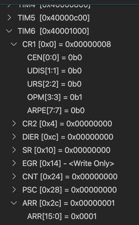

Here's the status of TIM6 registers on first entry to Delay_us function with delay = 5 [us]
On the exit from the function (before executing clear UIF) the registers are as I would expect them - with CNT zeroed, UIF set and ARR = 199 (5us*40 -1) :
This seems to give me 5.75us which is good enough I think. 0.75us or 30 commands seems about right for overhead coming from the function call, I think.

Read out and check/post the TIM6 registers content.

Yes, I'll check the registers. JW above also suggested that. I looked at them but I will post them later if other suggestions fail.
