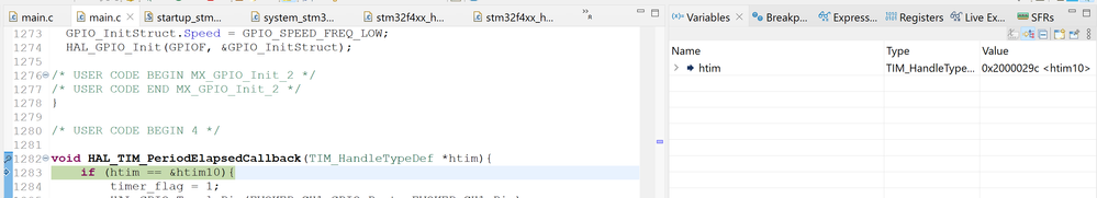

To help diagnose what is going on, set a breakpoint in the callback where you set timer_flag. When you hit that breakpoint, set another breakpoint in your main loop where you test timer_flag. Hit "run" and see what happens

I placed the breakpoints at the callback function and timer_flag line. In the debug session, the arrow next to the line jumps to the call back function and the arrow stays at htim == him10 line every run button hit. I captured the screenshot. I don't know how many times I pressed the run button but the arrow stayed at htim == him10 line.
