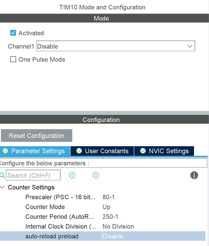

I set a timer timer in global interrupt mode. I monitored successfully a GPIO toggling with desired interrupt frequency. But a counter didn't increase in every timer interrupt cycle it was stuck at 1. Do you have any suggestions about the problem?
Thank you,

The current setting of the timer is like that,

Do you have the TIM10 interrupt enabled in the "NVIC" tab of the timer config dialog in CubeMX?
Does your callback ever get called? Set a breakpoint and see.
AE104
Senior
Yes, it was enabled.
Yes, I placed a toggling command for a GPIO pin and it worked.
