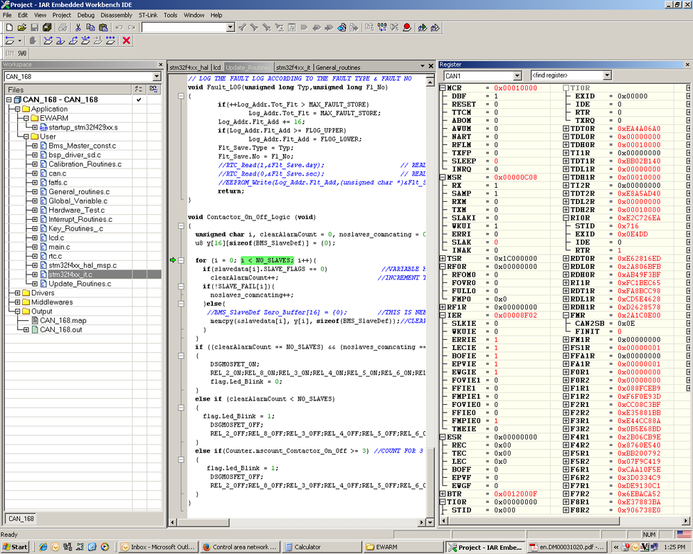

Dear clive i wanted to share register values am obtaining while debugging , please have a look.
Above image is the image taken when no slave device is connected.

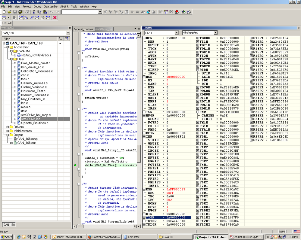

Above image taken when slave with ID-1 connected to my hardware, please have a look at ESR register, which is CAN error status register. Which shows lot of errors registered upon recieve of data, but still i didnt recieve any interrupt..
‎2017-05-13 8:01 AM
You'd have to dig into the HAL to understand why the interrupts are not dispatched to you.
Yes the error count looks very high, perhaps you should be looking at the transceivers and termination on the bus, especially if add additional devices to the bus changes its behaviour.
