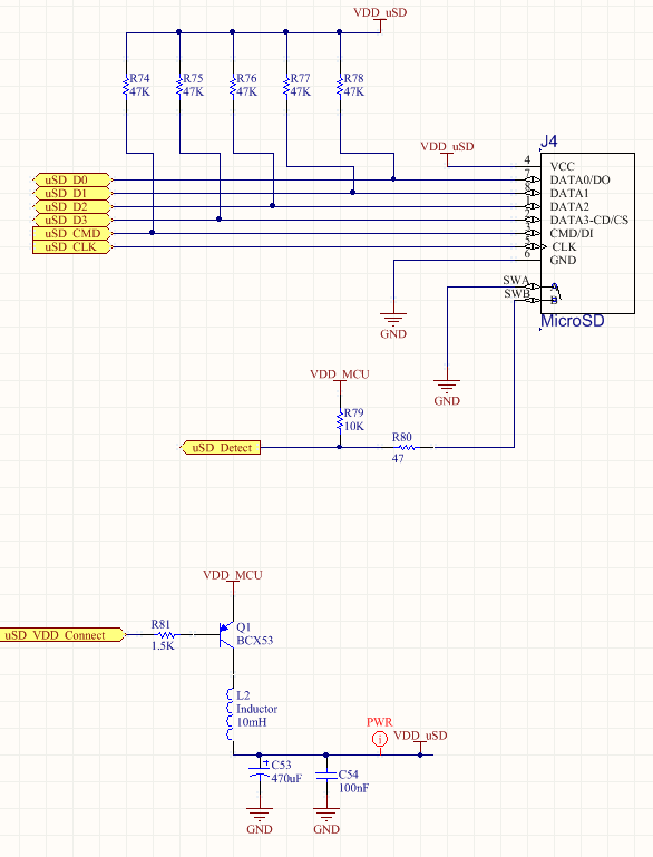

STM32F7 SDCard FR_DISK_ERR Error
Posted on May 14, 2017 at 09:03
Hi there
I waste much time on mounting sdcard in my prgram. the chip is stm32f745vg and i work with Firmware version 1.7 CubMX 4.19 and Keil 5.16
in CubeMX, i choose SDMMC1 in 1-bit mode with clock 48MHz(PLLQ=9) and FatFS --> SD Card. i leave Fatfs Options in Default(no change). other Configurations:
 Flash Interface --> Enable
ART ACCLERATOR --> Enable
Instruction PreFetch -->Enable
CPU ICach --> Enable
CPU DCach --> Enable
GPIO Configuration
SDMMC divide Factor=0
when i try to use f_mount function, i receive FR_DISK_ERR error as result Value.

    Tesla DeLorean
    Guru
    May 14, 2017
    Posted on May 14, 2017 at 20:04
    Should your function call HAL_SD_Init(&hsd1, &SDCardInfo1); ?
    Looking at the FatFs level isn't going to shine much light on failing layers below that.

    Nemui Trinomius
    May 16, 2017
    Posted on May 16, 2017 at 02:12
    Dear Ehsan Behravan.
    Why not try reference board like STM32F746-Disco?
    AFAIK,Many problems lies on D.I.Y. hardware(lack of pullups,weakness powerlines....).
    Ehsan Behravan
    May 16, 2017
    Posted on May 16, 2017 at 06:14
    Thanks for your reply.
    my board is a custom board and i have not  authority to change it to a Disco-Board.
    I've Designed SD Circuit from ST example Boards. only difference is a transistor for selecting the power of sd card. it means i should RESET a GPIO to connect sd power. i will attach the circuit.
    every yellow ports in the figure, is connected to MCU directly.
    Ehsan Behravan
    May 16, 2017
    Posted on May 16, 2017 at 08:49
    it worked. there is a problem in hardware level. I omitted the transistor(BCX53) and connected VDD_MCU to VDD_uSD directly. everthink is OK.In fact the transistor has decreased voltage level. so VDD was lower than Vdd High.
