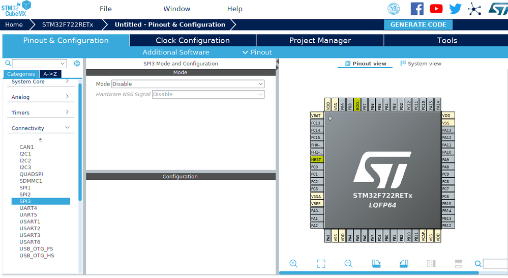

It's possible to control 5 SPI devices with the STM32F722RET6? LQFP-64

You could walk the datasheet and see if you can instantiate 5 separate SPI, or use CubeMX.

I have two SPI sensor mems and one dual/quad SPI and QPI flash memory and one SPI OSD.
Can I use any pin for the SS/CS selector chip?
QSPI has fixed/committed pins for NCS, common CLK between Bank1/Bank2
64-pin is quite limiting
Yes, any GPIO pin can be used as CS#/NSS (for normal SPI, not QPI), and one SPI controller can serve as many peripherals as you want this way. Don't enable the Hardware NSS Signal.
Be careful at the end of the transmission, don't set the pin high too early. Read the Procedure for disabling the SPI section in the reference manual on when it's safe to do it.

So I'm going to use so:
SPI1 for the two sensor mems and two gpio for the CS#
SPI2 for the SPI flash memory
SPI3 for the OSD
BR
Yes, I have not space, 20x20 mm board
I'm going to use SPI, not QSPI
